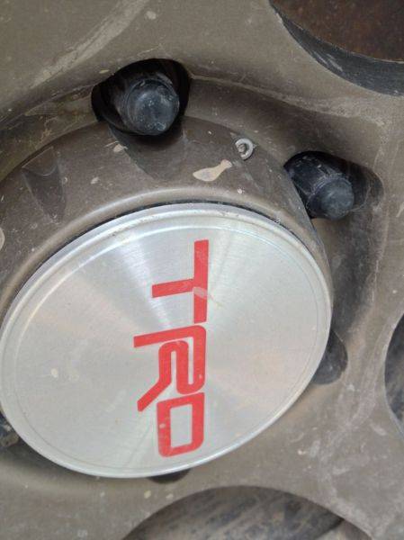

    Switch to APR studs? But I think your right about the bora spacers being your best bet.

    Extended thread lug nuts are also another option.
