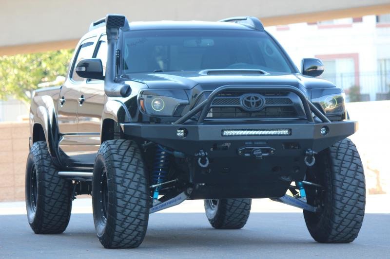

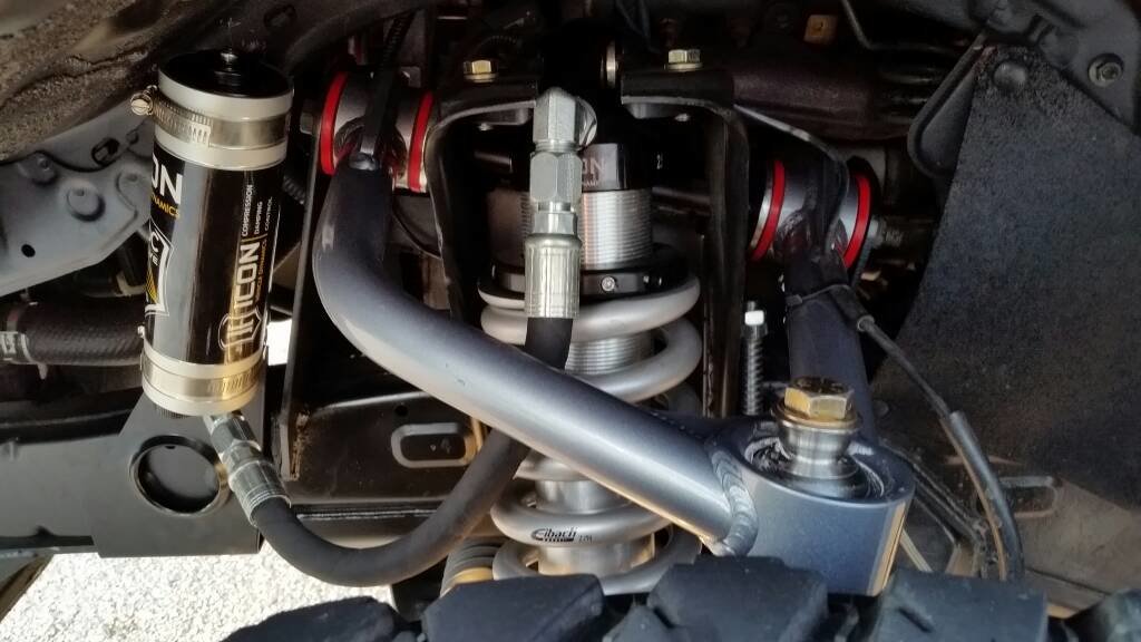

    Coilovers? Look like Foxs I think

    Expos in the rear?

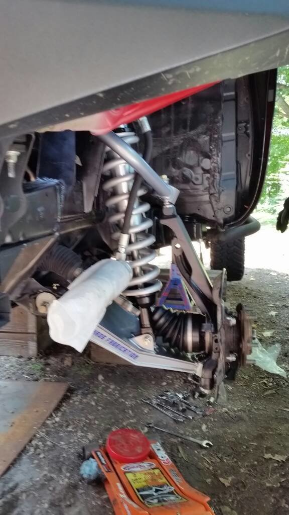

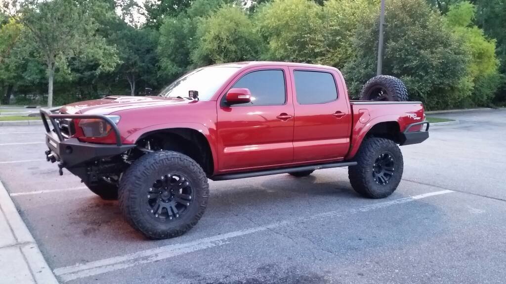

    Fox rr coils in the front w/ tc spindle gussets and lca gussets - tc UCA's too.
    Rear is the Dakar leaf pack and jeep XJ shackles.

    Excellent setup :thumbsup:

    Dig the mud flaps, Craig.

    My father in laws shop made me add them to pass inspection.:eek:
    Once I put them on they kinda grew on me.

    Thank you! I'm going to get it aligned tomorrow morning. :D

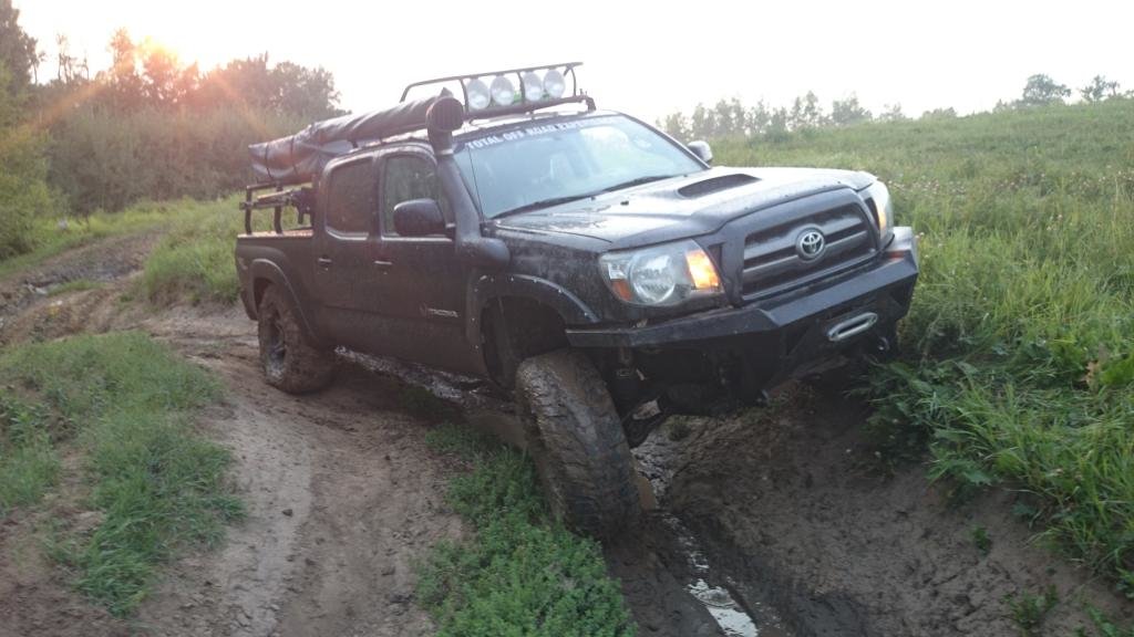

    Only rub I'm getting is on the driver side cab mount at full lock in reverse at full stuff, 35 12.50r17, 17x8.5 wheels 5.25"BS with 1.25" spacers

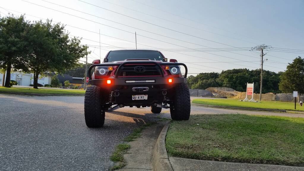

    So awesome man, really looks good.

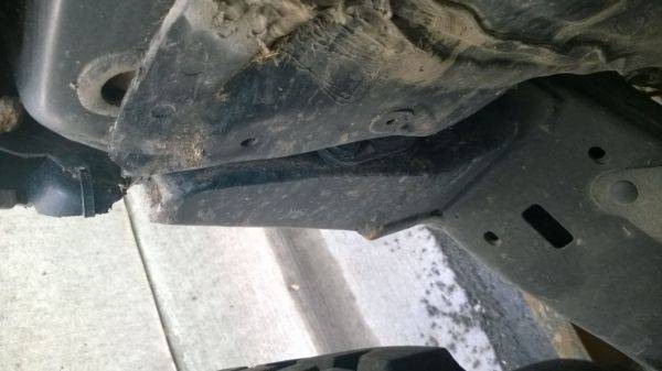

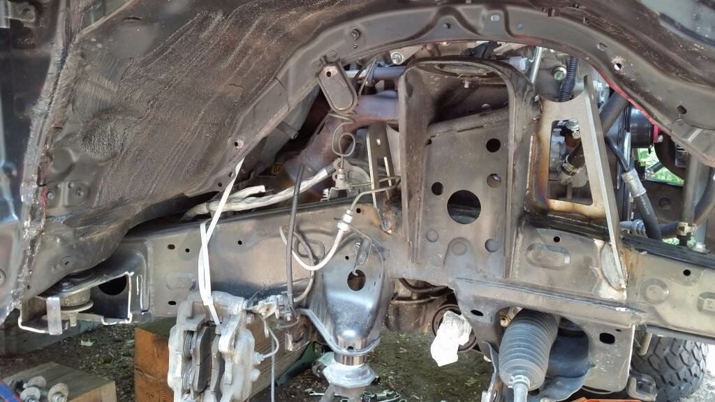

    Pre Trim:

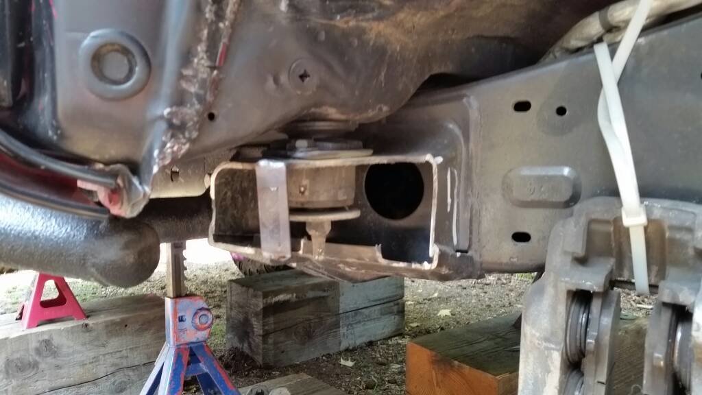

    Post Trim:

    AaronArf, your truck is definately one of my favorites. Very well done.

    Thanks for posting. I had to cut way more than that.
