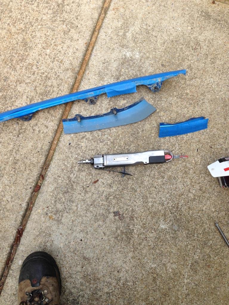

    I will take a video when I chop mine this weekend. I plan on using a skillsaw/jigsaw with brand new blades, we will see how it goes. As far as removing the flares, it's pretty easy. Remove the visible screws, remove the fender liner, and if you are crafty enough you can pop the plastic tabs out without breaking them. I wasn't so crafty, I broke all mine and just bought new ones. If you get the flare off and there are clips still in the fender, just turn them 90 degrees and they come right out. A pair of channel locks helps.

    From my thread. Use the super awesome tool to set your line and cut away :) Dremel is my tool of choice

    Tin snips FTMFW.

    1.5" reinforced cutoff wheel. About 10 of them :p

    Use a jig saw! Wood blade for the plastic and a metal blade for the rest.
    dremel with a metal wheel for anything that's tight and also used it on the plastic with a plastic wheel.

    I used an ingersol rand air body saw. Works awesome and won't cause any hear to build up and chip or bubble the paint.
