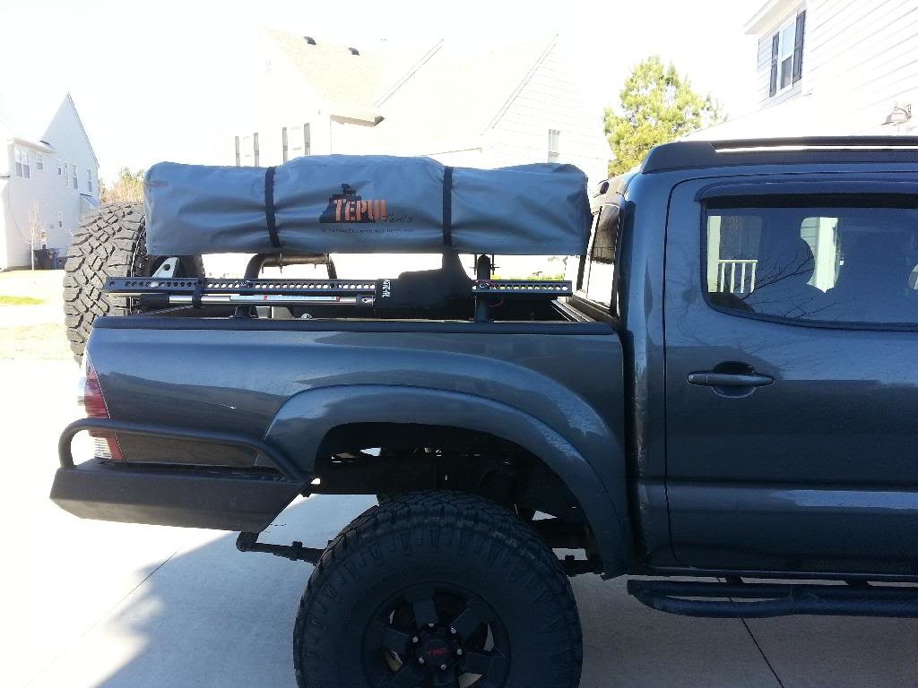

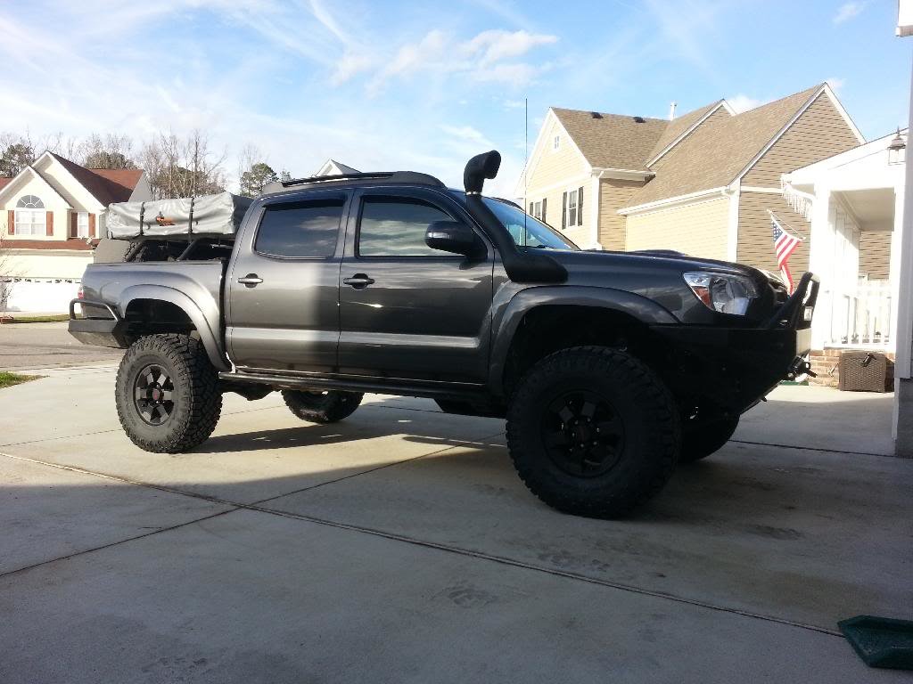

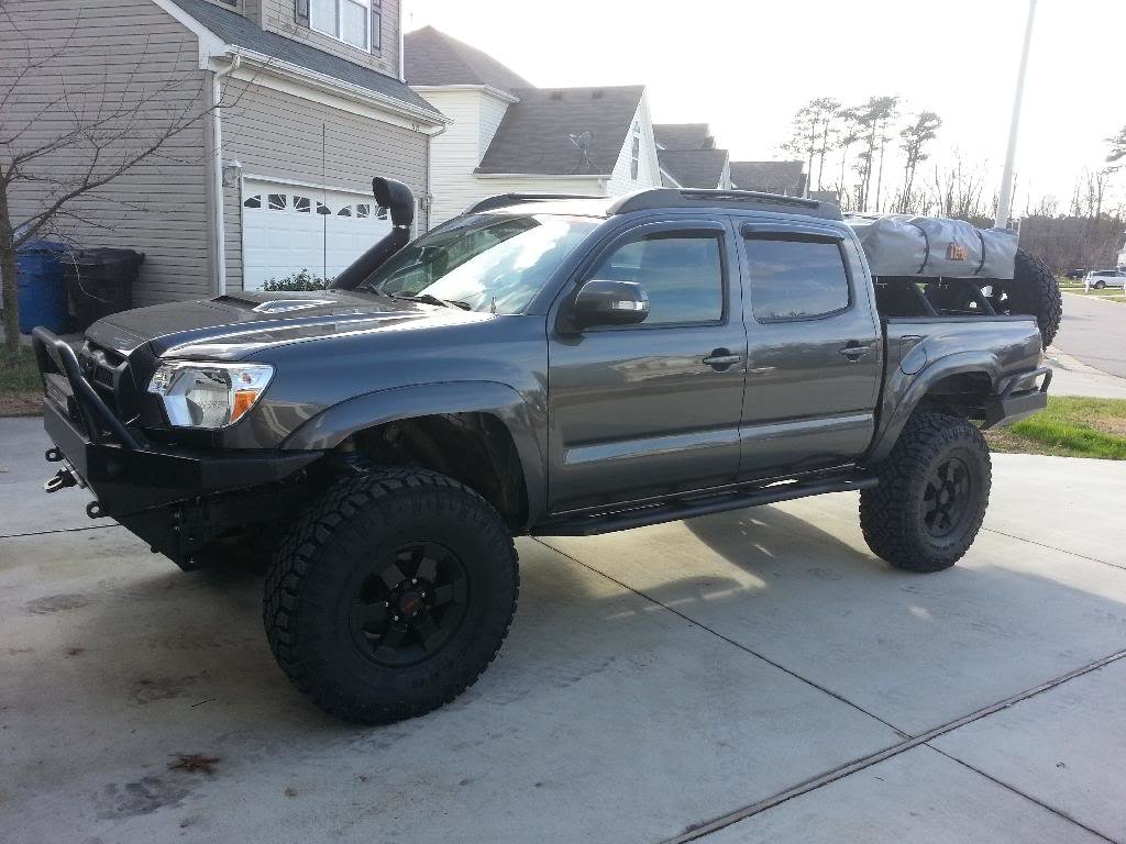

    So I've been lagging on getting my fender flares done but finally trimmed the rear flares. I will be doing the rear how I did the front by using 3m adhesive to reattach the cut off inner piece to have more of the factory look. Here is my dilemma, I took 2" out of the front flares the entire radius of the flare since that seems to be the minimum clearance for 35's. The rear really doesn't "need" to be cut to clearanced. If anything, it would be the rear part of the flare a little. So I cut 2" from the rear and less on top and in front. I didn't want to cut 2" all around to avoid having a massive wheel well opening.
    Looking at it now, I think it looks alright but seeing as the front flares are thinner than the rear, I don't want it to not look proportionate. In factory form the rears are thicker than the fronts anyways. Before I cut the metal I want to make sure the flares are good so I cut enough metal. Having the metal under makes it a little difficult to visualize it. If anything I'd take another 1/4"-3/8" off the top and front to make then more proportionate to the front flare. Once they are good I can continue and adhere the cut inner piece to make it look factory like the fronts.
    I'd like your opinions. What do you guys think? I know I can be pretty anal about stuff and that it's more work than most would be willing to do, and that fiancé with me. I would like a few opinions on how they look and/or how they are shaped and if they should be done a bit different. I've asked a few friends (not really automotive people) and have gotten different answers. Any opinions would be appreciated. Thanks.
    Here you can see the trimmed piece to get an idea for what was cut off. More off the rear and minimal off the front and top.
    Nate
    Edit: the bottom rear will soon be cut for a high clearance rear at the body line.

  4. Sep 13, 2014 at 3:15 PM
    #2484
    TacoDeLaPlaya
    TacoDeLaPlaya Total Automotive Performance Sleeper Cell
    Apr 15, 2013
    #102133
    925
    Bobby
    Del Mar, CA
    06 Silver Access cab
    Custom sotoshi deep dish grill 6112 front 5100 rear Leer 100xl
    I think those look good like that. Any difference is minimal and i like the proportions anyway

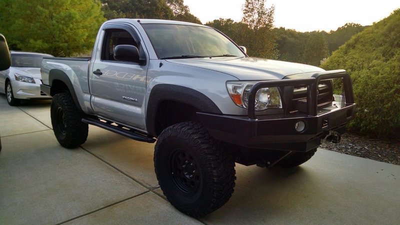

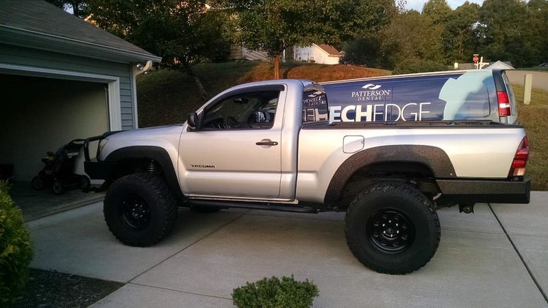

    That looks clean. How did you trace the outline? Or was it free hand?
    Like you, I have a relentless HC rear that should be getting to me soon. I'll be cutting off a bit of the bumper to line up with the trimmed fenders. I have no problem hacking away at the truck. I just don't want it to be one of those small things I didn't do while I was at it then have it bug the hell out of me down the line.
    Edit: did you use that auto edge trim stuff?

  6. Sep 13, 2014 at 4:53 PM
    #2486
    JLink
    JLink Well-Known Member
    May 9, 2010
    #36795
    12,582
    Josh
    Ocean, NJ
    Lifted, Locked, Armored. Ready To Wheel.
    He didn't do it, Craig homertaco did and it was a complete guess and didn't have the truck to reference from. Just happened to work out perfectly lol. Yes he has door edge trim on the fender and flare.

    HomerTaco
    Mar 28, 2010
    #34129
    45,874
    HomerTaco
    HomerTaco
    HomerTaco
    No, I'm just that fucking good. :cool:
    Yes, marked it with a sharpie & cut with a dremmel multi max.
    FWIW I knew how the rear Relentless HC bumper sat in relation to the fender wells on the truck - I did help install the thing. ;)

  10. Sep 13, 2014 at 9:45 PM
    #2490
    loco
    loco Who wants to ride my Brack Burrito???
    Dec 2, 2012
    #92254

    Nate87
    Nate87 Well-Known Member
    May 7, 2013
    #103748
    751
    Nate
    CONUS
    2013 AC TRD OR
    Phil, I like how yours turned out. The proportionality looks good front and rear. That's what I'm hoping to attain and is the main concern with mine.
    Craig, I was going to wait till the bumper came in to start trimming the fenders but the wait has gone a bit long so the rear needed to get done to match the front. I got tired of rolling around with only the fronts on. I praise you for the work you do on the flares. It's very time consuming to make them look factory and good above that.
