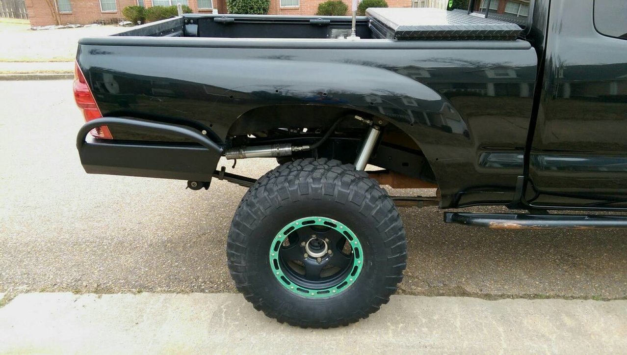

    allmotorrex
    allmotorrex Grove St. Fab
    Aug 29, 2010
    #42441
    16,746
    Gideon
    Memphis 901
    08 SR5 4wd 2.7
    NWF crawlbox, 5.29s, rear Detriot, front Harrop, 37" SXIIs, 17x9" KMC Grenade Crawl beadlocks, Dirt King 3.5" LT kit with King shocks, Fox 12" smooth body RR, BAMF shock kit, AP 3" springs, ext. brake lines, custom 1 piece driveshaft with .135 wall tubeing, GSF front rock crawling bumper, GSF rear bumper, Relentless Fab ifs skid, BAMF k/o sliders, X2O 10K comp. winch, TP glass fenders, OKled 20"bar, EBS dimpled/slotted rotors, EBS green pads, custom K&N CAI, LCE headers, FM Super 44 w/h turn down, URD MAF, Spec clutch, LCE heavy flywheel, URD short shifter, TMPer M1 Abrams shift knob, Amsoil oil, Cobra 75wxst w/h 4' firestix, Grillcraft, FXR TRS, T1 eyelids, custom ADV Monster 60 lights, bed lights, speedo light mod, Glow Shift volt/oil pres gauges, Glow shift 2g column pod, Optima yellow tops dual battery setup w/h IBS system, Pioneer DEH-P7200HD head unit, Pioneer 600W 4ch & 350w 2ch amps for doors and sub, Wet Oakle covers
    I used a 4" grinding wheel. Was done in a few mins.

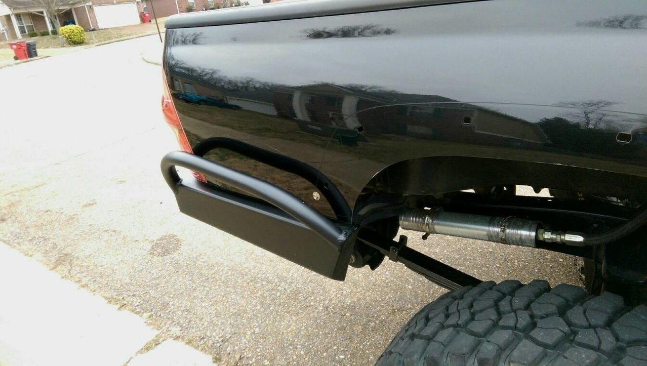

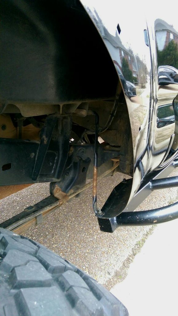

  19. Feb 9, 2015 at 2:52 PM
    #3159
    allmotorrex
    Aug 29, 2010
    #42441
    16,746
    Gideon
    Memphis 901
    08 SR5 4wd 2.7
    I have been meaning to paint these things but I'm bad about just leaving surface rust. Haha but here's what I did ......
