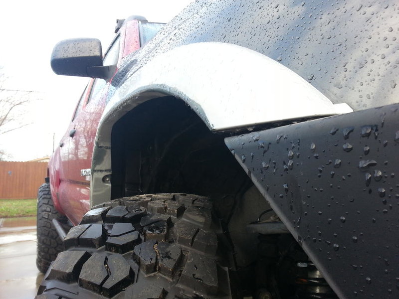

    Here is a picture from when I cut the rears. This is the line the snips give.

    Jigsaw! Best way to to it. Use metal tooth on fenders and wood blade on flares. Dremel was also helpful with plastic wheels for the flares.
    I did my front fenders with a 4" grinder took forever to make it perfect. rears with jig saw went easy.

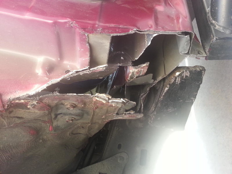

    3lb sledge and my boss telling me I wasn't getting bonus..... 2 hours later cleared for 35s. 1 hour and 45 minutes included drive home and remainder of work day.

    Ha ha:D you know what, you can get a little clearance with that but to be hones if you have a full day available to work on it its not to bad... I broke mine up in a few days, a few hrs here and there. First. Step is taking out the seat and carpet, then electrical in both kicks and fuse box, grind with a wire wheel all factory caulking ( which is very flammable), fut the whole pinch welf off and the bottom corner. Fold over and then tac weld it back, worst of the job is sealing the firewall back up! Use either a good silicone (no cheap stuff) or windshield install silicone installers use, paint and then youre done

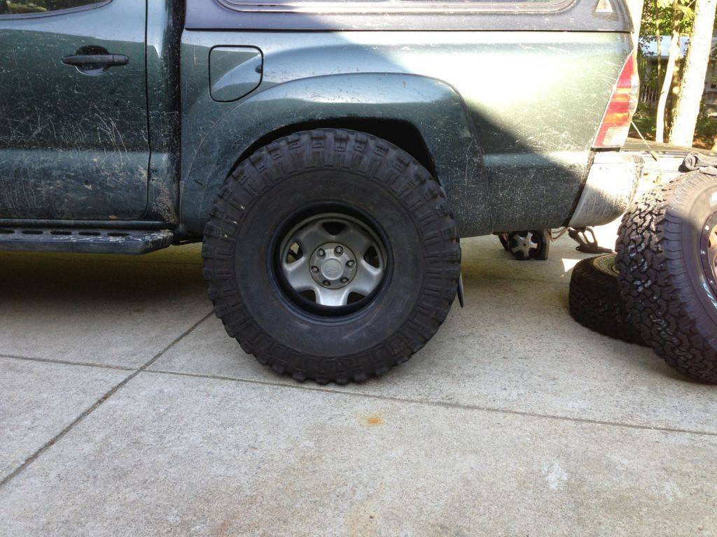

    I clearing 36s on the same body mount chop I had for 285s. If I chopped the "ear" off I'm sure 37s could clear without much issue. Here's my tires standing next to a stock tacoma with the 245 tires, I thought looked pretty funny
