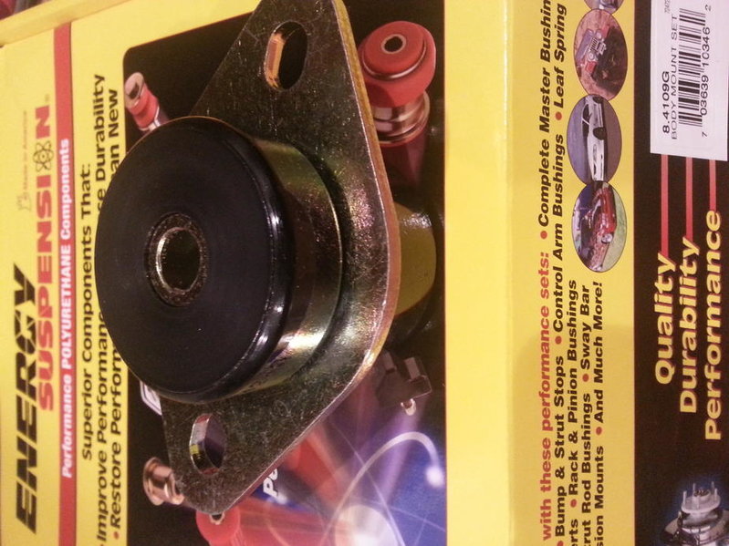

    Anyone use the energy suspension poly mounts? Mine just came in and was thinking of seeing if I shave the poly off maybe 1/8" , about 1/2" off the plate and cutting my body mount further back where it starts rubbing. My body relocation is coming in soon but wanted to see how far back it can be done with the stock mount before I cut it off. Any opinions?

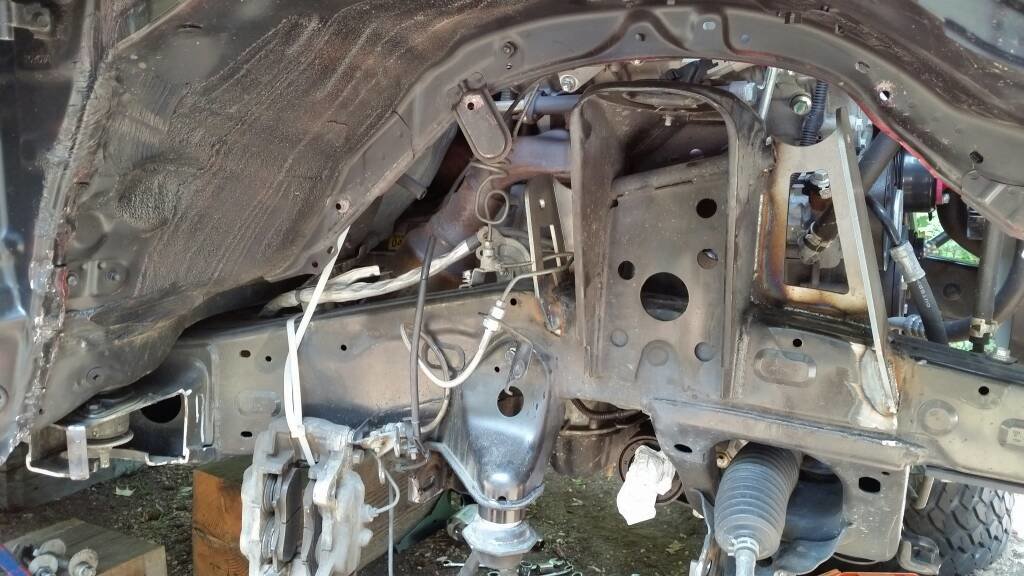

    After all the cutting and banging I painted it black too. I habr a pic before paint which look pretty bad, a lot less obvious in black

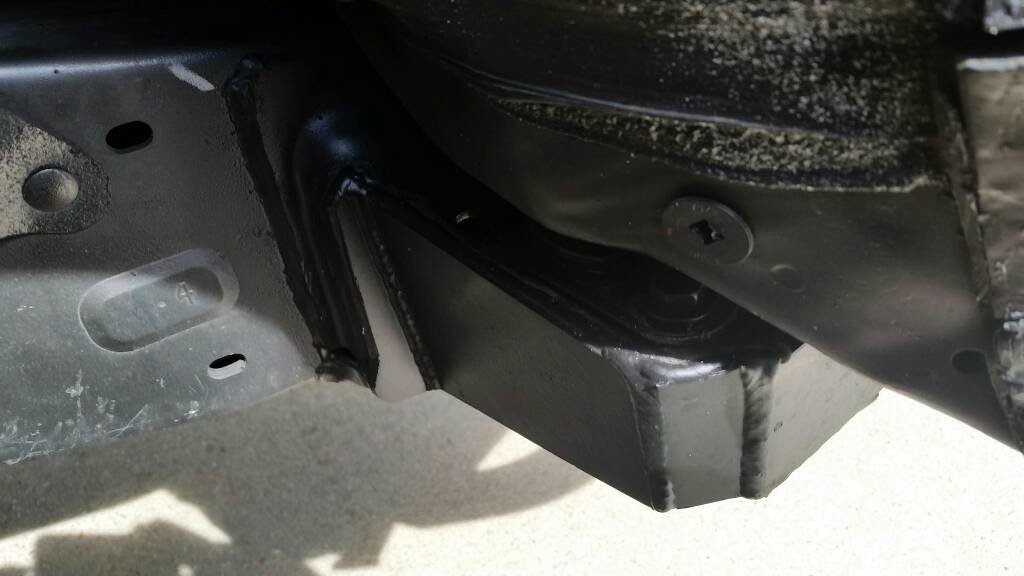

    You can cut the stock mount up a lot....

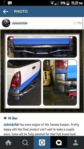

    Not 35" tire related but figured I'd share this ! That rear bumper = :drool: uploadfromtaptalk1423718575854.jpg

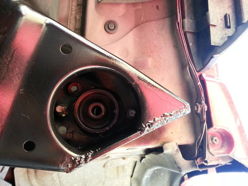

    I do have a +2 LT kit...so I'm a good bit away from my cab mount. Probably didn't need to cut as far back as I did but it was easier to just do so incase I had rubbage. I clear everything at full lock/bump/droop only thing I'm currently rubbing is the top of the fender well which should self clearance after a few hard hits.:D:D
