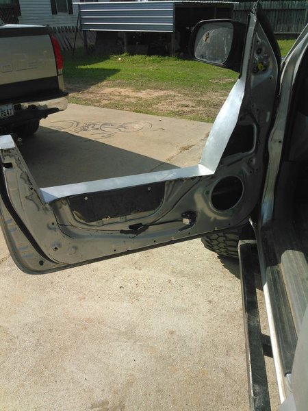

    As ghetto as it sounds, I purchased a slim latch from Speedway hoping it would work and make install cleaner. Well turns out the latch released from a top pull rather than a down pull which would mean the cable would have to be ran over the latch. Unfortunately there isn't a ton of room with my cut lines so I actually cut up the stock latches. I cut all the plastic surround from em(the plastic is what operates the inner door handle) and what was left was a small portion. This portion was the outer door handle switch which is actually metal. So after shaving the stock latch down, I just ran a release handle I got from speedway also and connected it to the outer door switch.
    The doors are not finished. By far. I still have to add speakers and finish up the welding on the inner skin but here's a pic FWIW
    I was going to add cupholders until I remembered I already have 5 of em. Even with the half doors lol so decided not to deal with em yet. uploadfromtaptalk1423774005853.jpg

    I still have to do finish welding, add the speakers, clean it all up and paint but this is as far as I got. I bolted up that one piece above the handle in case I ever need to get to the latch.
