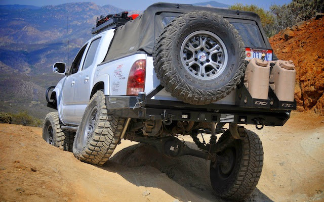

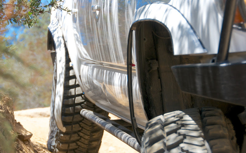

    i took off an even 2'' front and rear.
    additionally, i only have 5 leafs/pack, and rear bump stops so small, that i might as well not have any. the combination of the two means that my tire will sit much further up into the wheel well than someone with an 8 leaf pack and/or someone with a standard length bump, menaing they need to remove less. however if you have really wide wheels, or ones with less backspacing, you may need a little extra.
    here's what 2'' looks like. i have zero fender/bedside rub.
    i did slightly vary from the 2'' at the ends of the cut in order to blend the lines a little better.

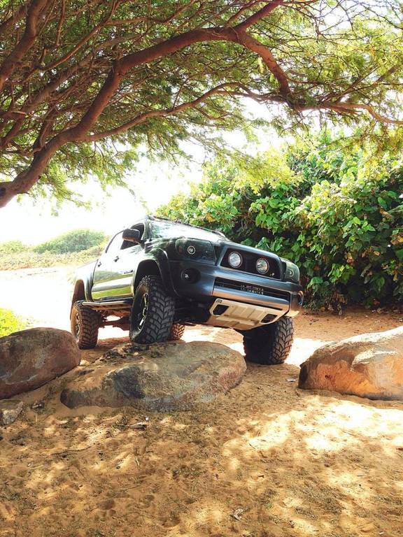

    4" front and rear. I have 1.5" spacers on the rear to almost match the track width of the front. In this picture you can see that if I had only 2" cut off I might have been rubbing the flares.
    And in this picture is when I cut off 3" and I rubbed the flares then.
