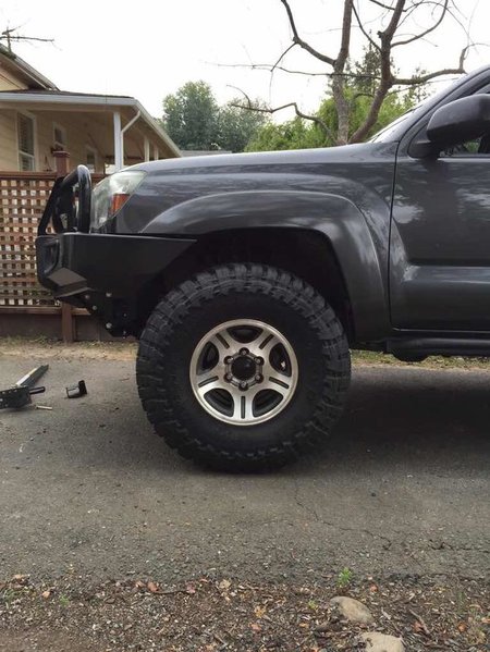

    Dang those snips leave a clean cut,

    Initially I cut the front using an angle grinder. I cut close to the line and then sanded it from there to make sure it was a clean cut. Sanding it chipped the paint and over heated it a bit. Once I got the snips I just followed my cut line on the front to better clean up the cut.
    For the rear I just used the snips.

    Snips would've been easy along with an angle grinder. I used a dremel the entire time I chopped my flairs :anonymous:

    Make sure you cut the actual fender back a little more then the flare so it looks better.
    For cutting use a jigsaw. Wood blade for plastic and metal blade fenders. dremel with plastic discs and metal discs to make any tight radius turns. A grinder with a metal cutting disc is also helpful to have around. I did my front with the grinder and it took forever, jig saw is the way to go! !!

    For the tight spot down by the cab mount area I used a POS electric body saw from HF. It actually worked pretty well. Dremel for the rest of the cuts.

    I love the square shape of your front fenders dude!

    His front fenders look like poo!
