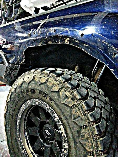

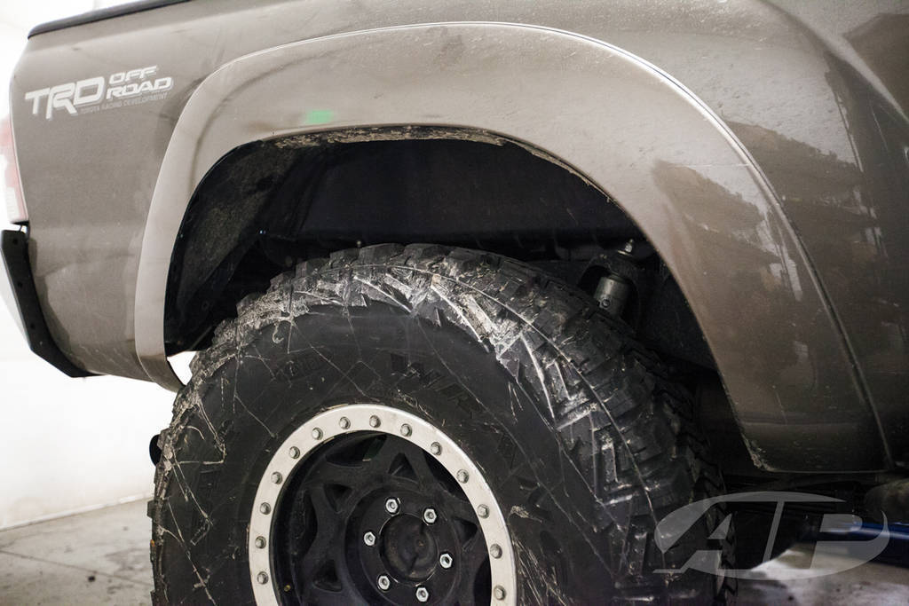

    The only thing mine needed to clear 315's was to remove the mud flaps. That was before the HC rear went on. Maybe the different setups of suspension and wheels/tires stuff differently :notsure:
    Here is a shot of what All-Pro cut on the rear of their Brownie to clear 37's. Maybe what you're talking about with cutting the rear.

    Its really all subjective. Tire brands, rim width, offset, uptravel...
    This build had to take more out then AP did for 37s! http://www.tacomaworld.com/forum/showthread.php?t=176526
