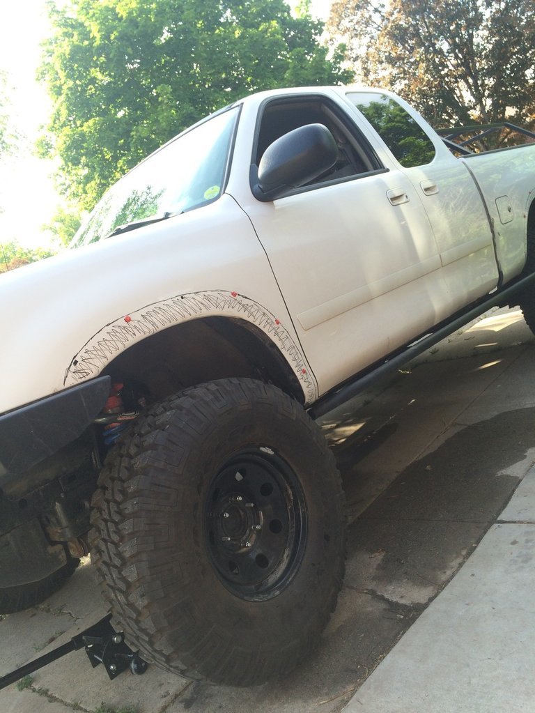

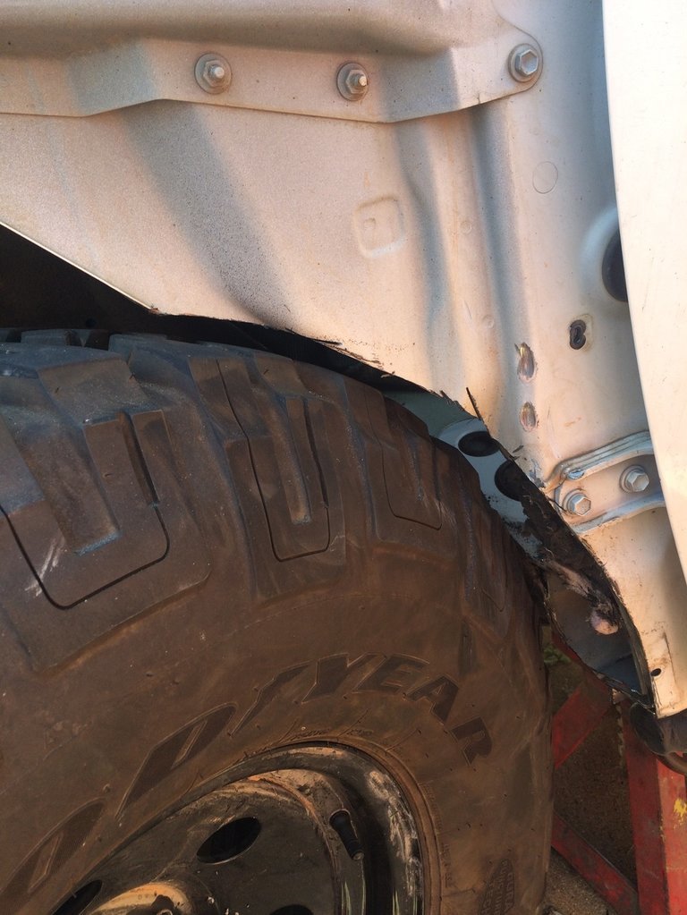

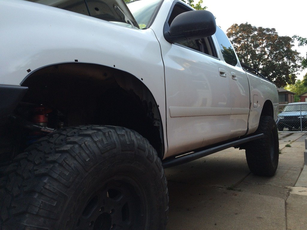

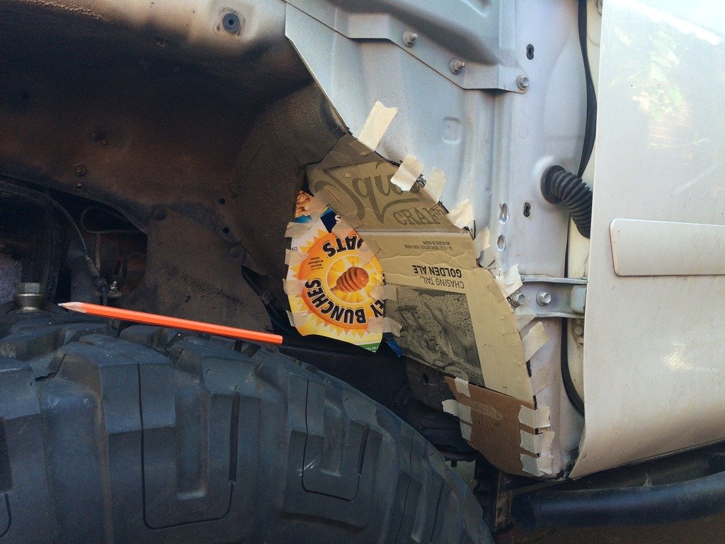

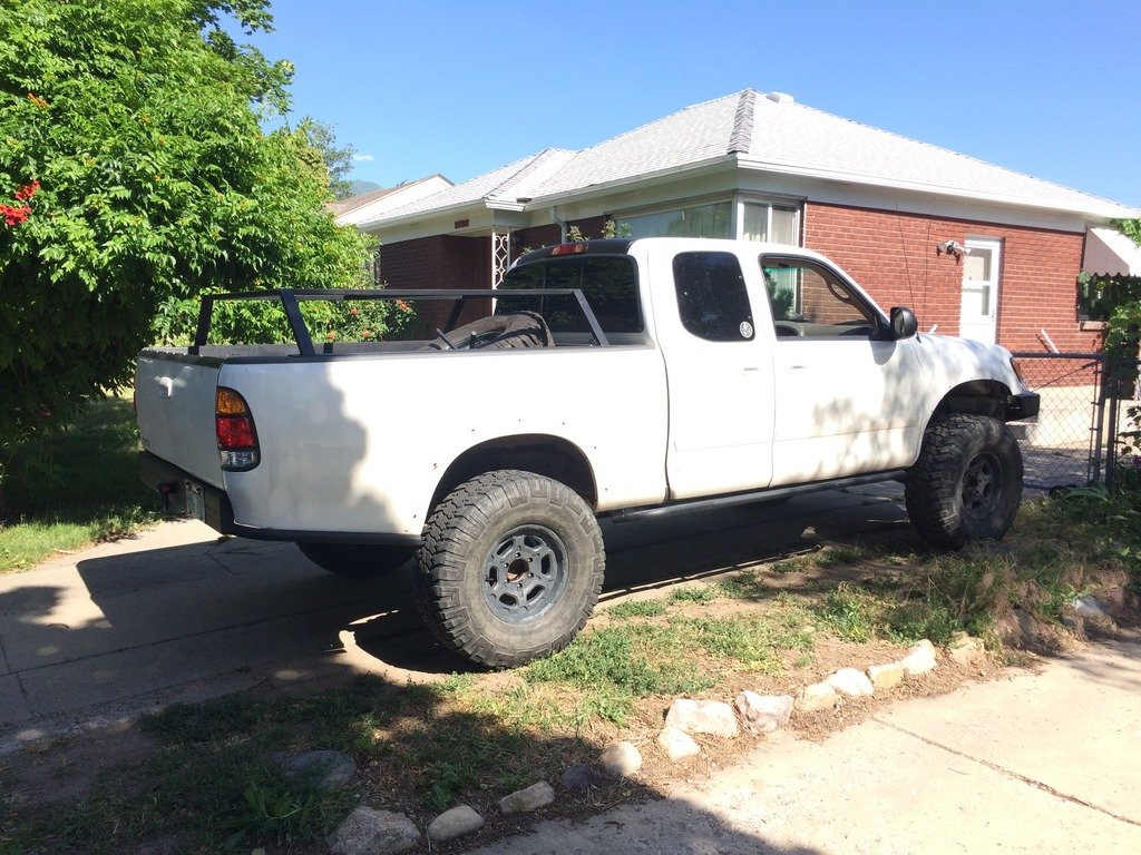

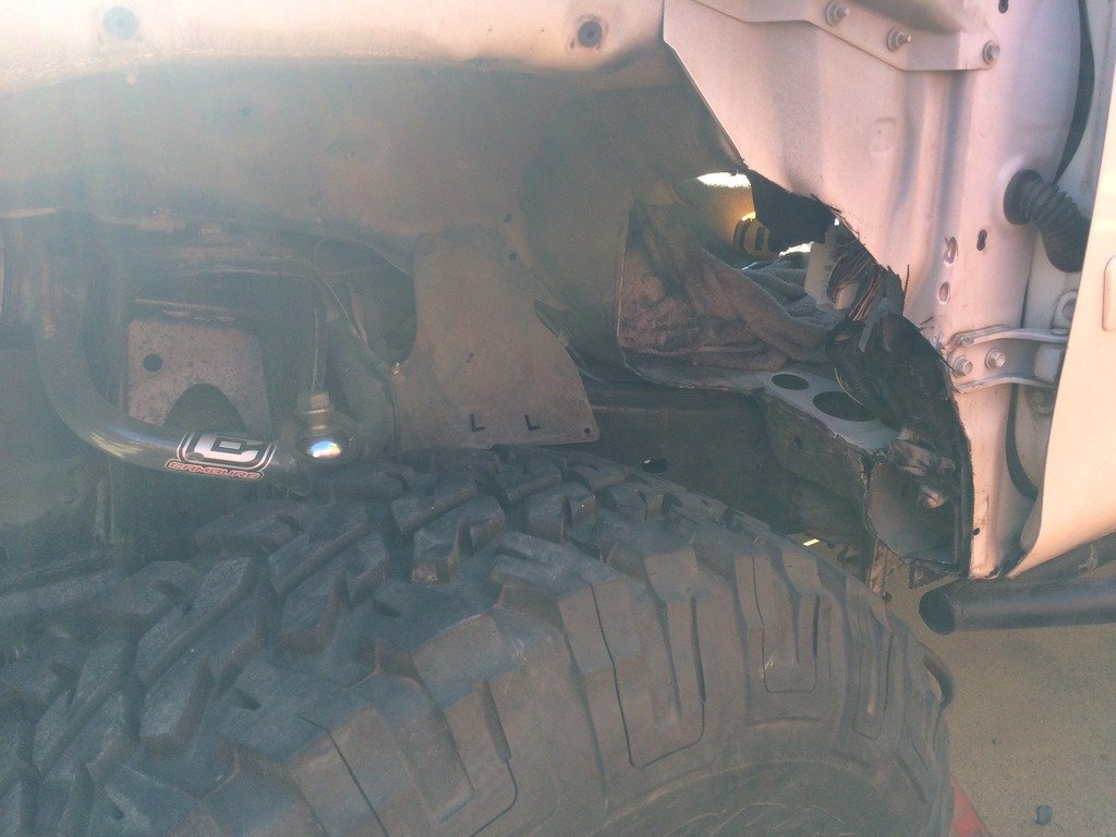

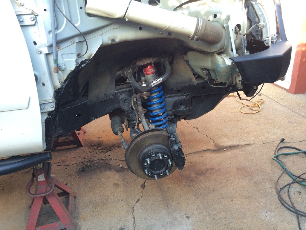

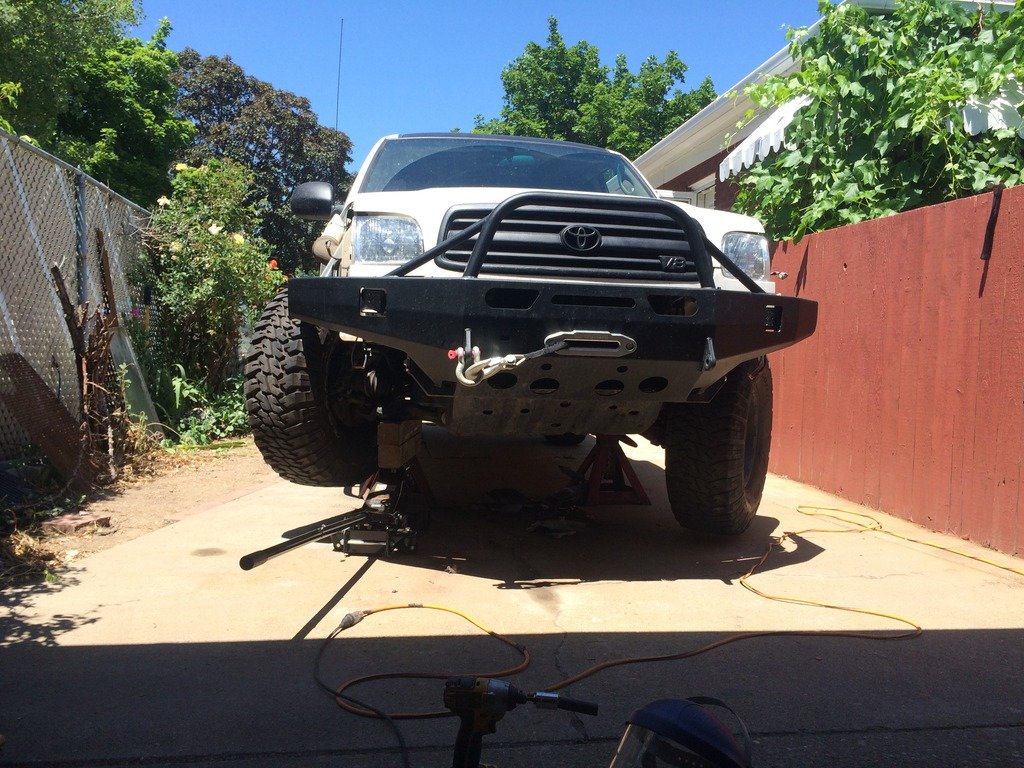

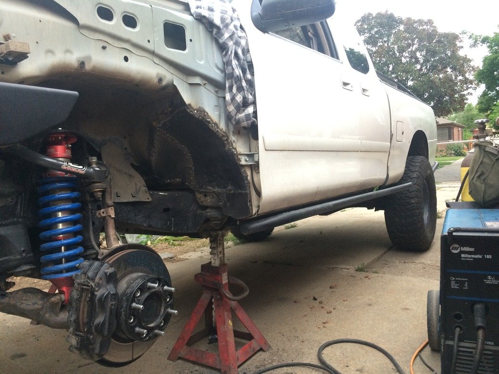

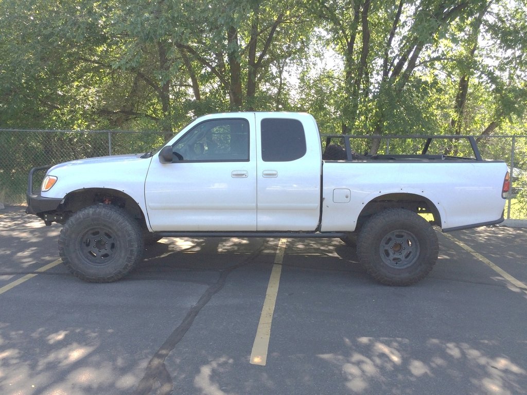

    Thanks to the info in this thread, I tubbed the firewall on my first gen Tundra to fit 35s with no lift. Currently set up with just 2" lift from my Camburg/King coilovers and Camburg uniball UCAs, with no rubbing at full compression and full lock. Thanks TW.

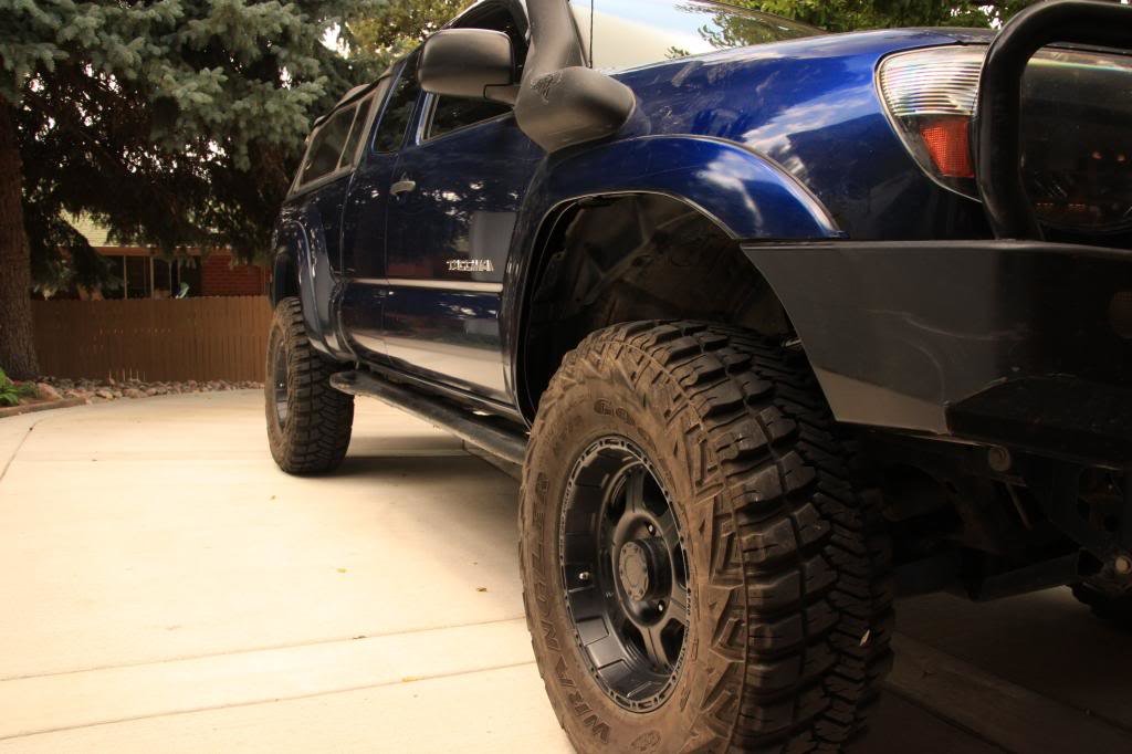

    For anyone interested on what 35's look like on a relatively stock Taco.
    No mudflaps, CMC, lower fender cut, and ARB cut. Stock TRD shocks and sway bar, Camburg 1.25 UCA and Dirt King stock length LCA.

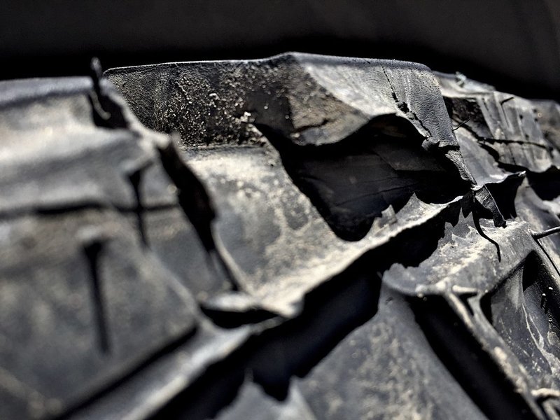

    I defiantly need to chop the fender but I haven't had any issues yet. The biggest problem was with the ARB bumper. I jumped the truck on a dirt road coming back from Bear Valley and it cut up my fronts. I got lucky I didn't blow the front driver tire.

    metal coat hanger, mold over tire. mark and cut the ARB on that arc

    That's a great idea! I just cut a straight line parallel to the existing one. Once I trim the fenders I'll cut again but at least I won't scallop my tires for now.

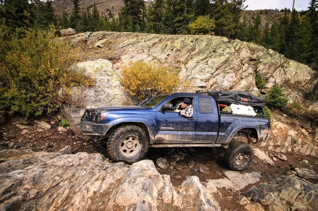

    back with 33s
    34s
    RockTherapy2013-510-1_edited-1_zps6b05cd_1936ee54504305f44a32deb3eeb554a594a0671c.jpg

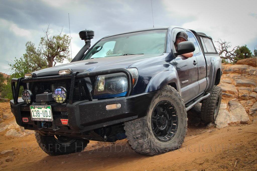

    and 35s

    Nice action shots there NYCO.
