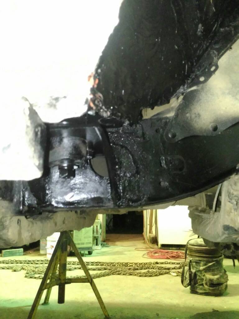

  16. Jul 20, 2015 at 1:37 PM
    #4276
    Robertocritser
    Robertocritser Well-Known Member
    Jul 21, 2010
    #40524
    7,216
    Levi
    KY
    08 sport
    ATM6969420 series
    Instead of filling the hole I tacked the new cab mount on then welded a plate to cover the difference in the hole 06b0638f1be70b624c3ce7e1e80f2d24_a5a0908aa09c534372c58c6135f81c72e8f6c04a.jpg7d3d6d564ac066419f4e0168518c8998_b10d001040ebfe71dcb0fb366f2557b193410d6c.jpg
    Haven't had a problem yet, wouldn't hurt to gusset it but I don't see a reason if it hasn't bent yet haha
    BigRedToy likes this.
  17. Jul 20, 2015 at 3:59 PM
    #4277
    Robertocritser
    Jul 21, 2010
    #40524
    7,216
    Levi
    KY
    08 sport
    ATM6969420 series
    One other thing is the kit is made for 2" body lift so the bracket support may need to be trimmed flush with the frame
