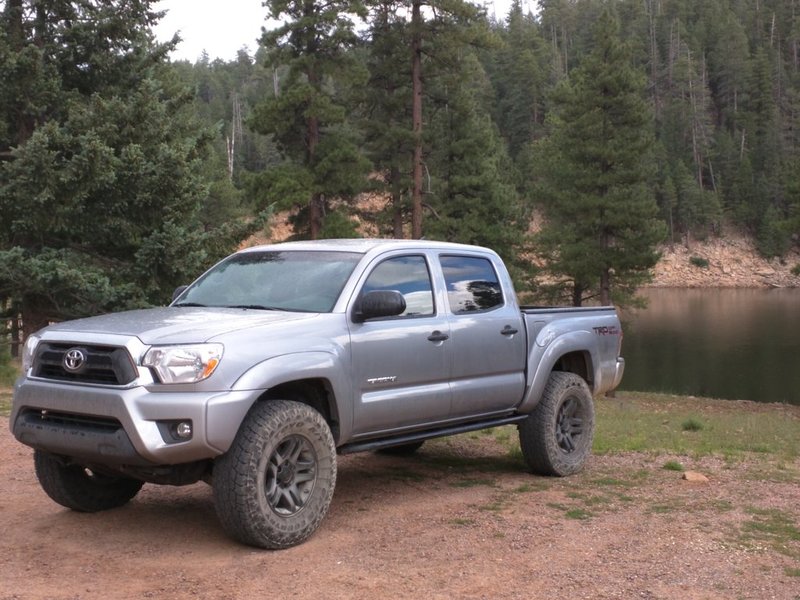

    Only needed CMC, pinch weld and a tiny bit of plastic/fender. This is the perfect size and I'm very happy. These Tundra wheels clear the TC spindle gussets and my TC Lowers with no spacers.

    What size 285/75/17's?

    Looks great Jon. The Tacoma wearing it's Big Brothers shoes and Toyo AT II's?

    You got it Bill
