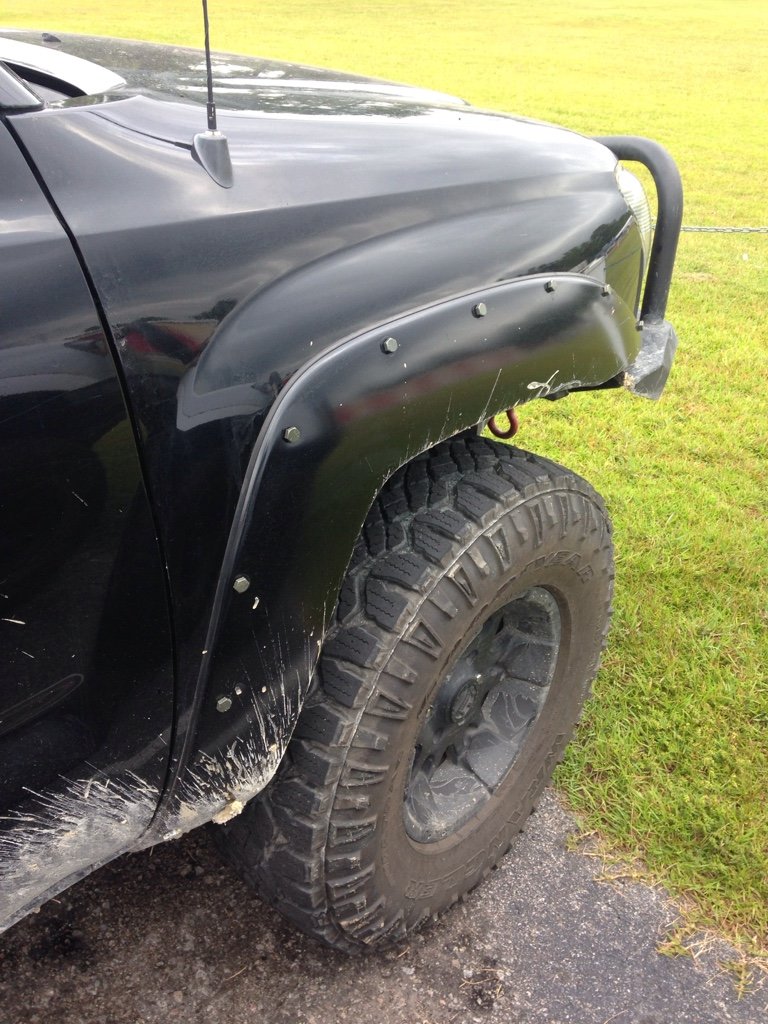

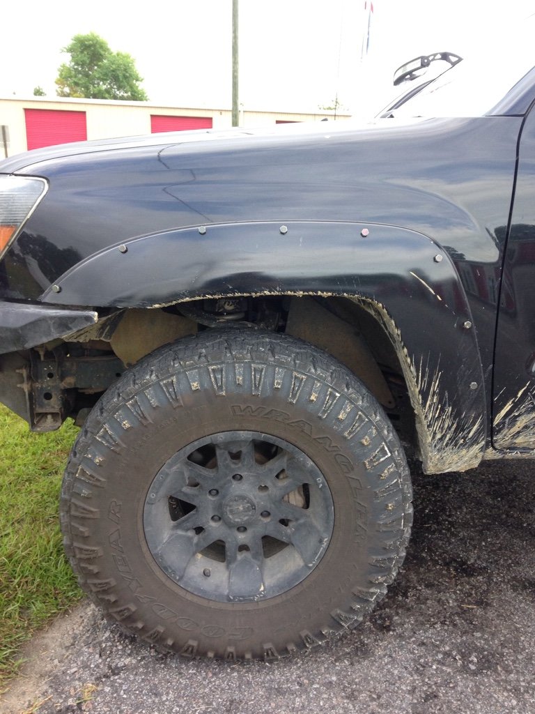

    I broke the bridges on my flares removing them to trim and drilled out the flares and did 3/8s bolts in place. The threading is big enough to catch the holes where the clips went in the fender so no need to use a nut on the other side of the fender and I can take the flares off in about a minuet a piece.

    Do it. How did you tell where to drill on the ones where the bridges had broken off already

    I lined up the flare with the clips that weren't broken and marked on the inside of the fender with a sharpie and drilled where I marked

    Cool. Remember that when you do mine. I'm thinking 3/8 machine screws with finish washers might look a little cleaner. You remember how many bolts you used

    34 bolts. More if someone had a stock rear bumper or front bumper

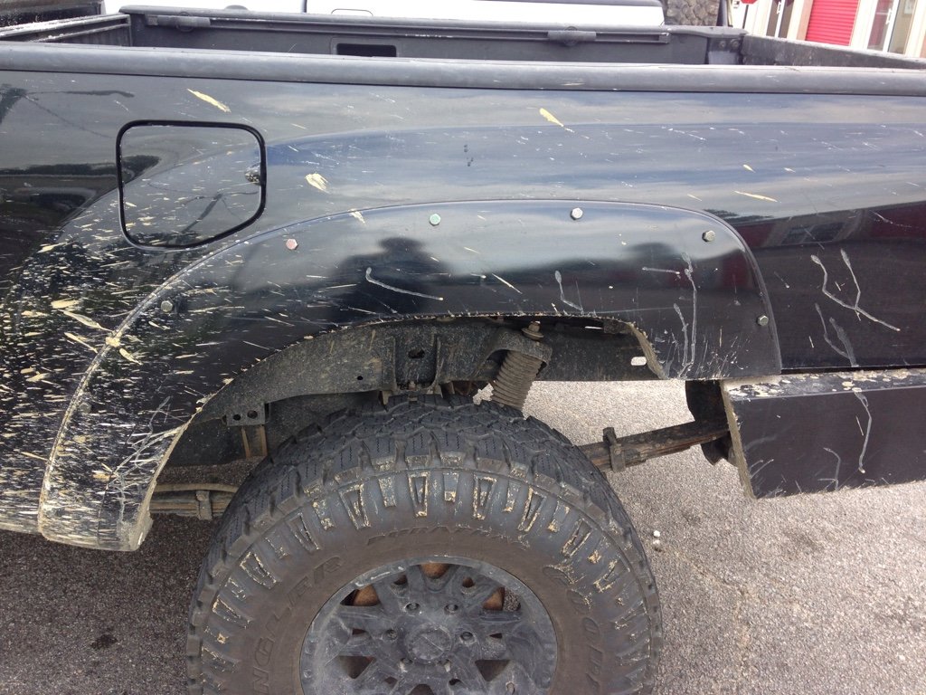

    What I did after trimming mine is I plastic welded the bottom edge back on for a stock look and to make it stronger. The thing that keeps mine on snug is every few clips I plastic welded bolts on the inside of the flare In place of about every third clip ! So now each flare has 3 bolts snugging it up and the front flares I also left the inside lip bolts on to secure them on

    Well done sir! I like that

    I like this method....this is the new standard imo for those wanting to keep those "skinny" flares on. Now come do mine please...

    Thanks, it was lots of work but paid off when done. I also had to buy a second set of flares to make one set20141217_093829.jpg

    If I remember right I think it was 2 & 1/8", the front flare where it sits nest to the bumper I went a little more to make up for the big tire clearance so it was about 2" and the from I eye balled to make it look proportional

    This is a great job!! Very clean sir!!
