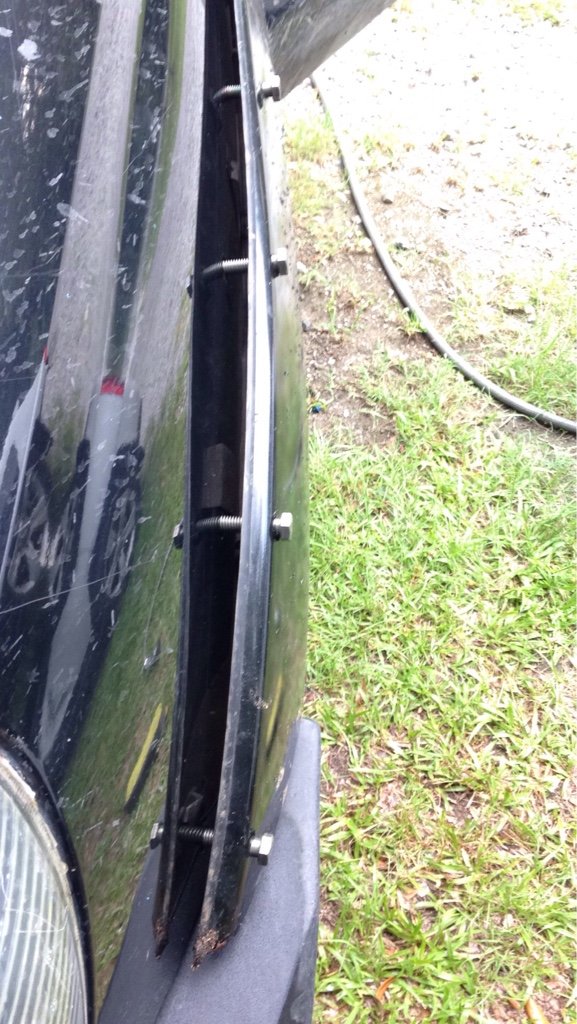

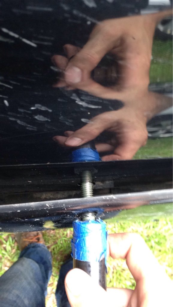

    i turned those fake bolts into real bolts on mine...
    36 button head bolts, 72 nuts, 36 nylon washers, 36 flat washer and 36 lock washers
    nut and nylon washer is used as a spacer then washer, lock and nut on the inside of the fender...
    only had to drill one hole on each side in the front...was able to line up all other holes to pre-existing holes on the fender

    That's interesting that you were able to utilize most of the factory fender holes. That would certainly make life easier. I have found a few companies that are making the pocket style flares. Now I have to convince one of them to cut 2-3" out of the side, which will mean creating new molds.

    Do what I did but make the flares have recessed holes to look like bushwackers and let those bolts go into the clip holes in the fender
    It would be easy if you have the machinery to make them. I'd be down for a set if they look good

    The threading on this bolts was perfect for the holes and actually threaded right into the hole with no need for a nut on the inside. I've tugged and pushed and shaken the shit out of them and the don't budge that way

    i was pleasantly surprised to see so many match up...made the install much easier than i was planning..
    used a buddy's electric snips which cut through the plastic with ease..then finished off with some edge trim
