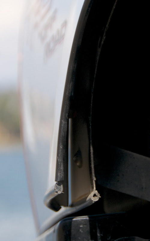

    The hard part is not the cutting, it's the fact that you are about to cut into a perfectly fine fender and flare. I have cut into almost every panel on my truck so I don't mind doing it. It's just that first cut that hurts. After that, it is easy.
    I used the same ones
    Just like the man said, use some automotive trim to clean it all up. In this picture, you can see the trim that I used. I heated it up using a heat gun and then pressed it on. Every few inches I see super glue on the inside to help keep it in place. I haven't had an issue with the trim coming off.
