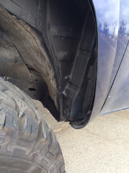

    Dayum! There's plenty to cut on that cab mount. That's a 33's CMC.

    It was already to the hole... guess the plate I used was pretty thick....

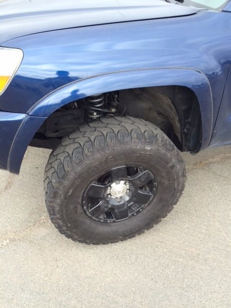

    Looks clean man! Super clean, thank you!!
    Did you cut the same amount off the actual fender and you did the fender flare?

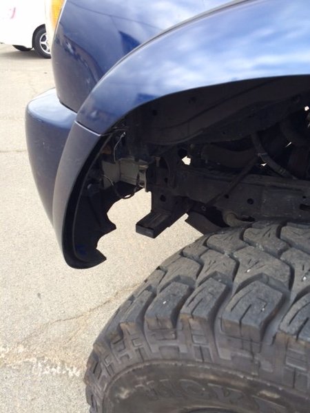

    Thanks man, appreciate it! And both the fender and the flare are cut the same. Maybe the flare is just a smidge longer than the fender to cover up the lines better.

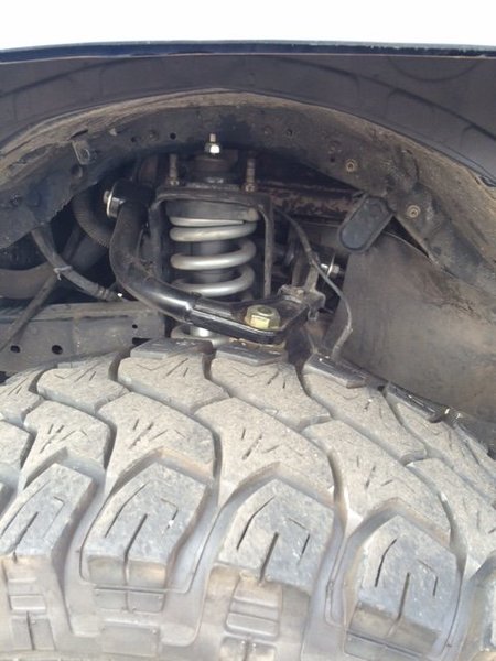

    I got my 315's on also, here's the cab mount. It's clearing for the most part. I need to beat my firewalls this weekend as that is where my rubbing is at. It's not bad but needs a beating nonetheless. Any trick to the firewall beating?

    Thanks man. I still have to pound the damn firewall in more.

    Those are pretty much the only pics I have. The rest look similar (truck on ramp). I just pulled up that ramp on both sides and cranked the wheels to check clearance.

    Just don't get too overzealous and punch a hole through it like some have done. Take your time, beat on it a little, check for F ups, beat it some more. Wash, rinse, repeat.

    And when you're done, apply a rubberized undercoating in the wheel well to help seal it up.
