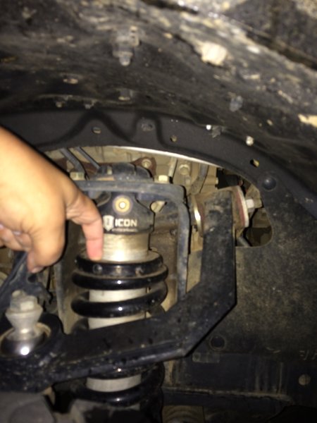

    I know it's not about lift. I want to lessen the preload so the truck rides better.

    get longer coil so you can ride with less preload...

    They're already 14x700

    Time for 15x800, #EAF

    lol then the truck would really ride like crap. How much preload do you have on your Icons?

    i was at 3/4" then i just cranked down 2 more turns recently, so it's a little more now...i have icon ext length with 14x700 kings

    I have the Icon ext travel with 14x700 icon springs. I'm at 1.25" on passengers side and 1.75" on drivers side. Is there any difference between the king and icon coils?
