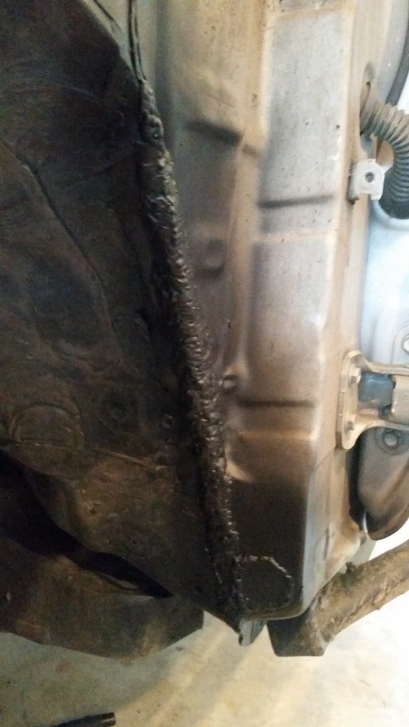

    I just did some cutting, beating, and welding in preperation of the 35s I will be getting.

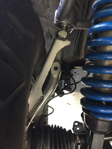

    Anyone know of a reason I can't run factory wheels with my 35's for street driving for a bit while I buy new wheels if that's needed? I have 1.25" spacers in the front. I'm thinking my wheels are bent or warped or some shit.

    without spacers you'd rub on the UCA
    sharp turns you'd rub on the frame more

    So relatively I should be good with the spacers minus the sharp turns

    No, you will be all over the UCA.
    This is with 4" BS, I believe stock wheels are somewhere around 5.5".

    How so with having the 1.25 spacer?

    Now I'm confused, I thought you were asking about stock wheels w/o spacers.
