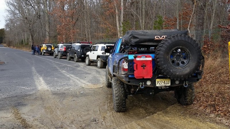

  5. Oct 27, 2015 at 2:09 PM
    #4505
    PSU Taco85
    PSU Taco85 Señor Member
    Jun 21, 2014
    #132394
    2,011
    optional
    '10 TRD OR mostly stock
    Plasti dipped hootus
    4" or less is what you want. Here's how far my stick out with 4" and 36x12.5

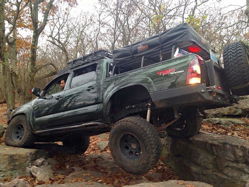

  8. Oct 27, 2015 at 2:26 PM
    #4508
    ckeene9
    ckeene9 Well-Known Member
    Sep 20, 2012
    #87325
    10,848
    Chesterfield, VA
    '12 DCSB Supercharged 4x4 TRD Sport
    See Build Thread
    Fenders cut 2.25", 4" BS, front wheel is at full stuff. Not much clearance with that much trimming, you will have a hell of a rubbing problem without cutting your fenders.

  9. Oct 27, 2015 at 2:30 PM
    #4509
    ckeene9
    Sep 20, 2012
    #87325
    10,848
    Chesterfield, VA
    See Build Thread
    Not much tire sticking out of the wheel well on 4" BS and 315's.

  13. Oct 27, 2015 at 2:42 PM
    #4513
    PCTaco
    PCTaco 36 hour Build
    Jul 21, 2013
    #108719
    4,231
    Adam
    New Columbia, PA
    '18 Access Cab TRD Offroad RIP '13
    Working on it
    Good pic of what's actually going to hit. Maybe I know a guy that'll give me a good deal when I get him to cut in my snorkel. Maybe I quit caring and do it myself. Truck is already pinstriped to hell anyway.
