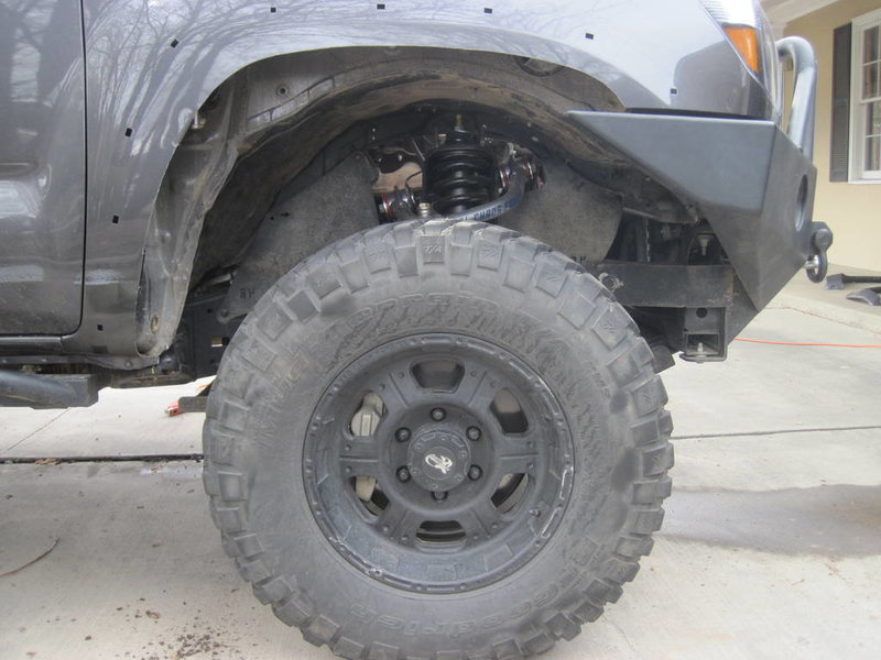

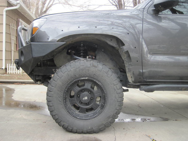

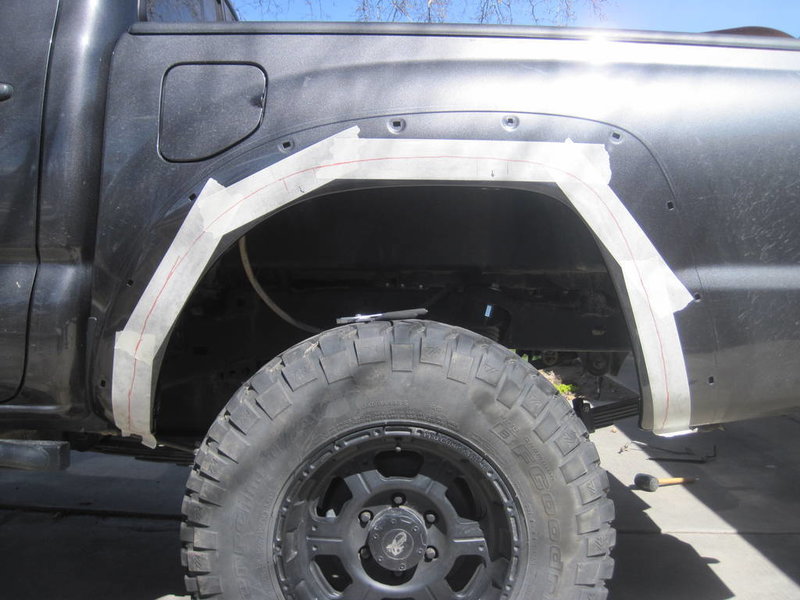

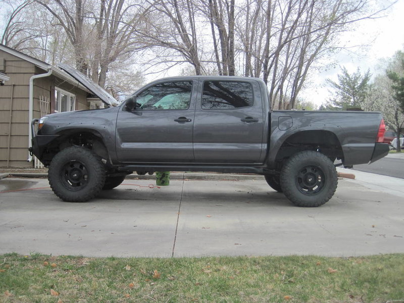

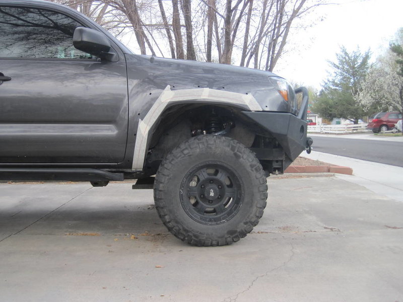

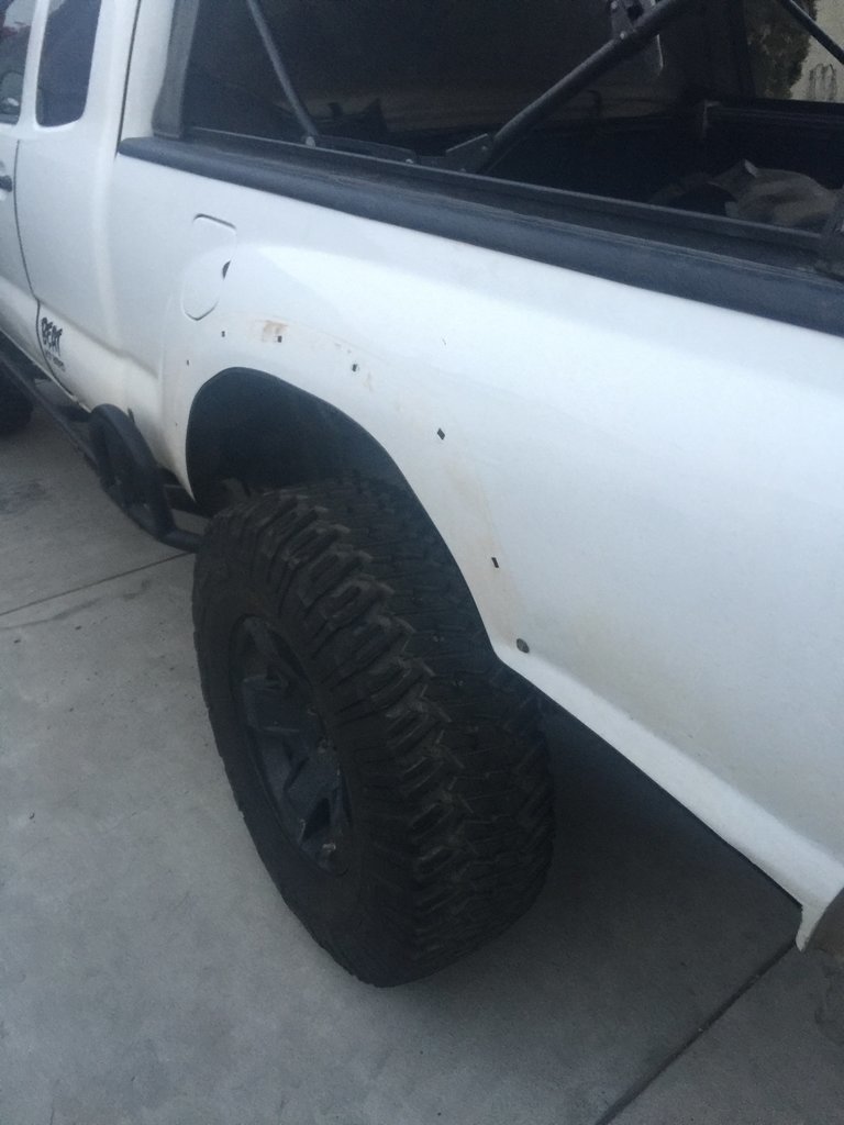

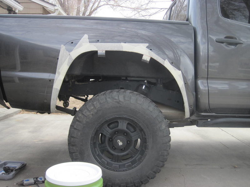

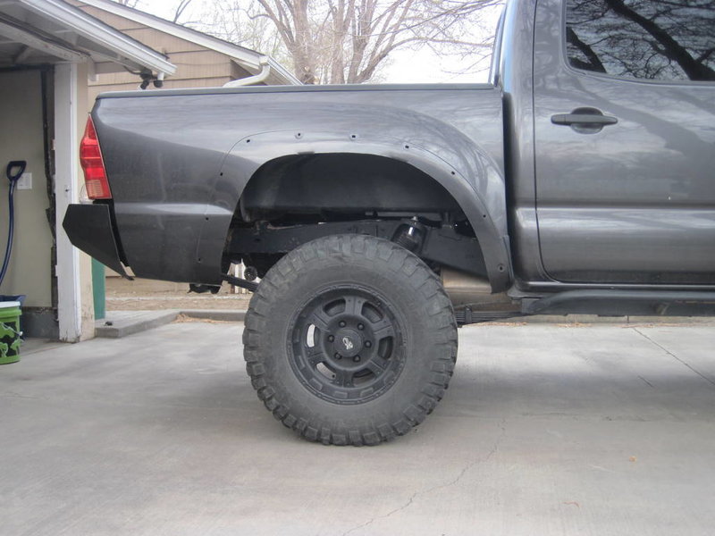

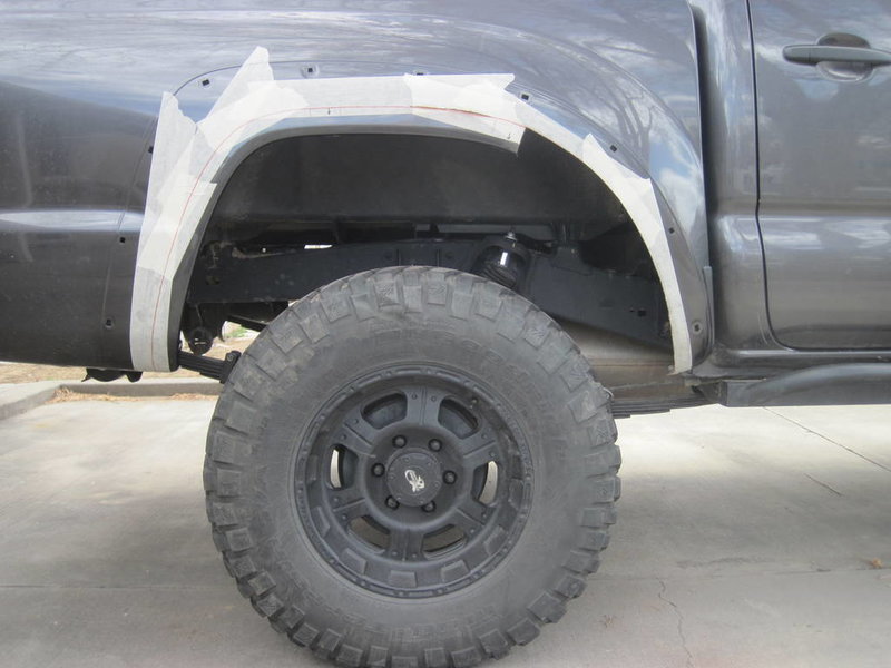

    Here is a photo dump of when I did mine. Used ruler wheel to mark of 2", didn't need any more than that, and cut away. Can't believe that was 2.5 years ago, time flies when you're having fun I guess.

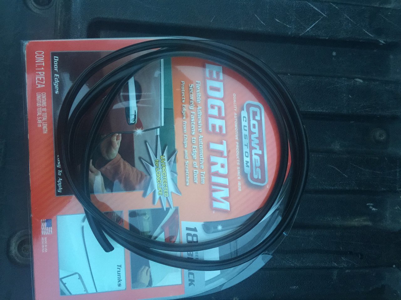

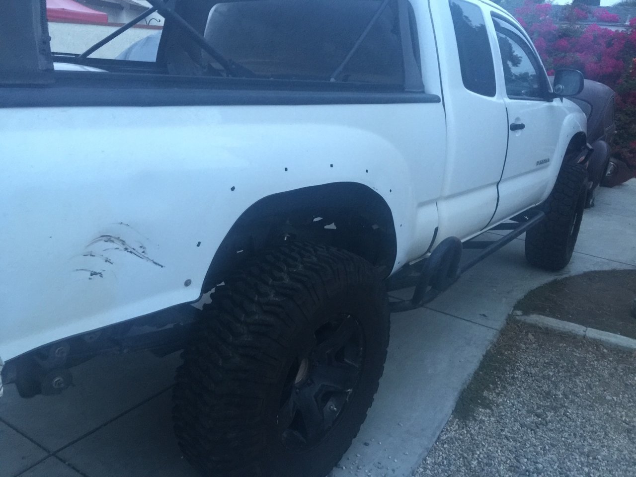

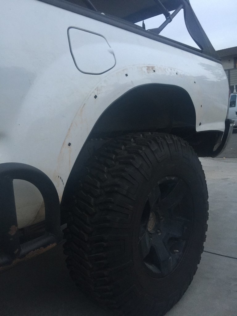

    After cutting my fenders I use door edge trim to clean it all up. Super easy to apply and I think it looks great. It cleans up any imperfections in the cut and now I don't have sharp fender edges. I know some people put their flares back on but I plan to run my truck with out them. Just need to plug the holes for the clips. What did you guys do as far as your open fenders?. Did any one put a lining back in?

    I've left my fenders open. Yeah, you get a bit more mud and debris in there, but it's not that big of a deal. Just wash it out when you get home.
