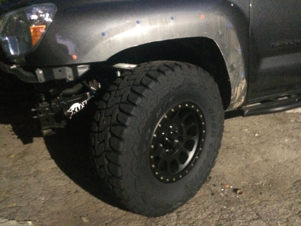

  16. Nov 14, 2015 at 5:52 PM
    #4776
    RileyLAFD
    RileyLAFD Well-Known Member
    Jun 7, 2014
    #131487
    830
    Riley
    City of Angels
    '14 DCLB Magnetic Grey
    I guess I've got to start this very soon....
  17. Nov 14, 2015 at 5:58 PM
    #4777
    weldertaco
    weldertaco Mr.13%bodyfat
    Dec 16, 2014
    #144371
    13,299
    texas
    TrailRunner
    4wd to 2wd conversion
    One wheeling trip and you're gonna realize you are going to have to cut more lol. Never fails.
  18. Nov 14, 2015 at 5:59 PM
    #4778
    RileyLAFD
    Jun 7, 2014
    #131487
    830
    Riley
    City of Angels
    That's exactly why I haven't filled them. And since these pictures I've already chopped some more.

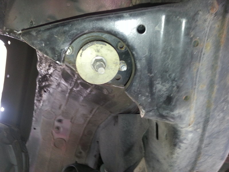

    Here is what I did right before I did a body mount relocation with the stock mount... I took it off completely after this but with some notching of the washer and plating the open area this would give great room for up to
    Edit: 37's with 2" spacer rubbed a little right on the rubber mount.. if I notched it I'd be OK if I didn't turn to full lock. Trimming the washer would have done the trick but I did a body mount relocation kit
