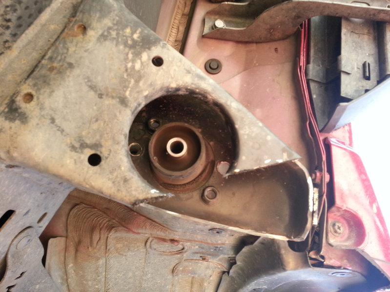

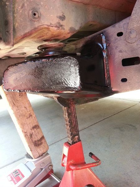

    If you unbold the mount and turn it so the 2 bolts are strait if you look from the side and drill new holes you can get a little more room20140529_133025.jpg 20140529_121659.jpg

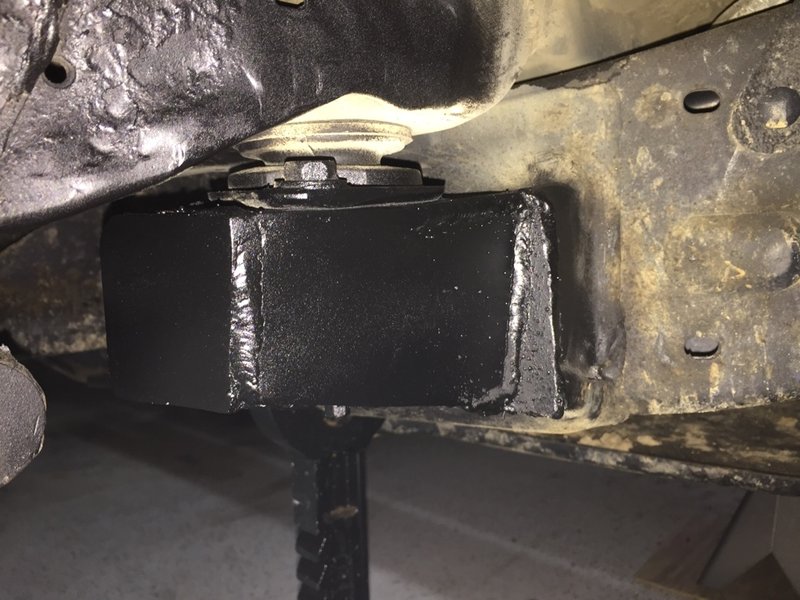

    I cut the old factory bold hole that is closed to the front completely off

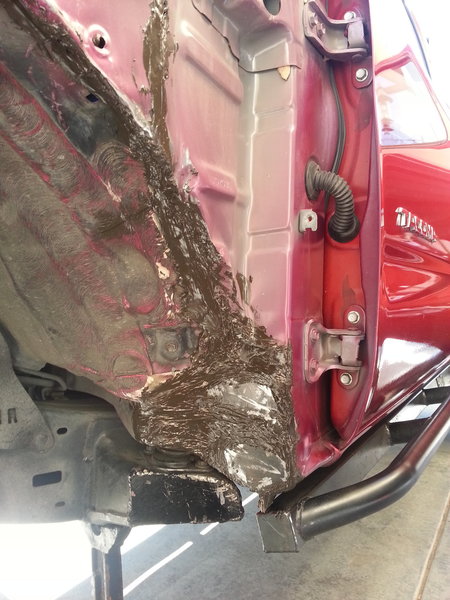

    Of the chop or relocation?.. i did not plate the second time i chopped more of since i was playing aroumd before i did the relocation here is the chop but if you do it this way I wouldn't leave such a sharp corner on the inside but would cut it back about an inch from the front to fit 35's:

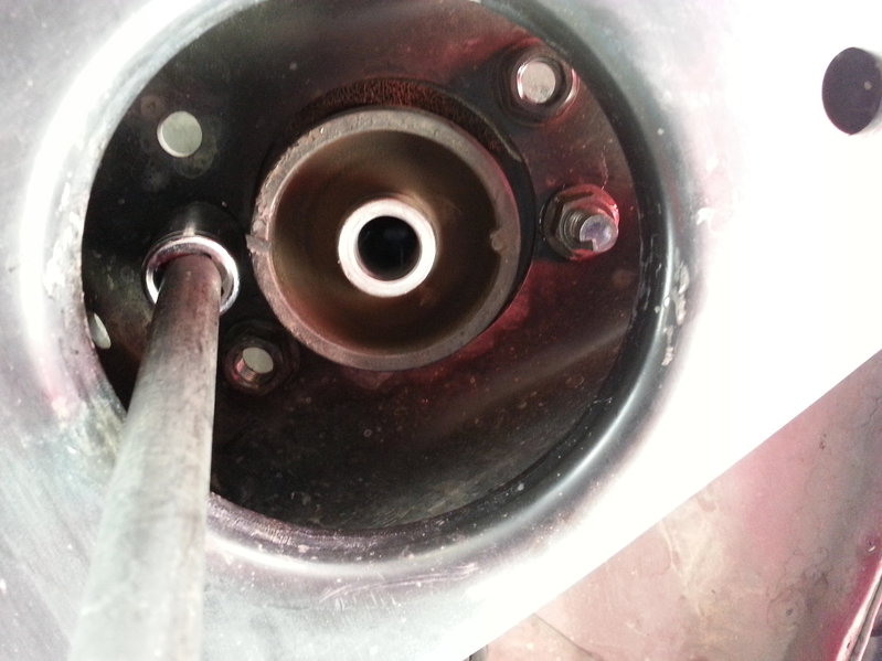

    The bottom corner was first to make contact at lock even with 33's ...

    Here is a pic with just the original chop and the firewall chop

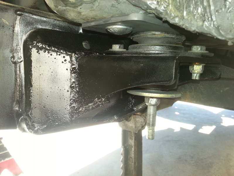

    Is this the stock location, just boxed?

    Yes

    Looks awesome need to find a welder around here to hook me up with something like that.

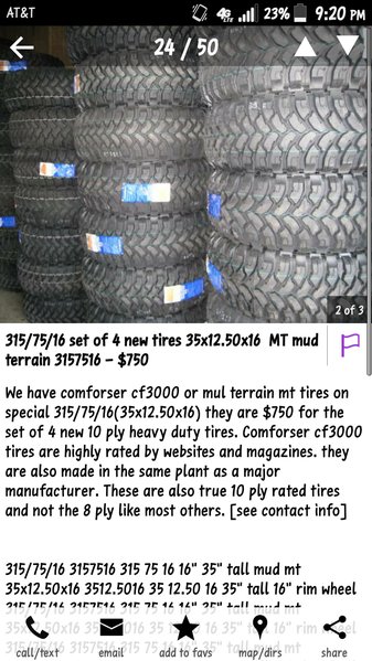

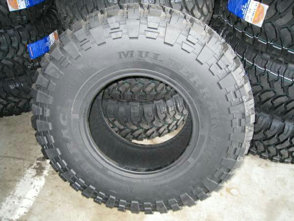

    Anyone ever heard of these tires before? uploadfromtaptalk1447557662789.jpguploadfromtaptalk1447557674482.jpguploadfromtaptalk1447557679344.jpg

    I'd stay away from these China brand tires, they will bubble, oval or blow out and cause damage to you truck or worst cause an accident. I prefer to stick with name brands.. even if they are not US made at least they will stand by their warranty if you get them from a authorized dealer.
    They all look good but are they going to hold up???

    Well I've bought new name brand tires multiple times and they always get chewed up on the rocks when wheeling and highway eats them up too. I'm still saving for a set but then I saw these today and was wondering if it'd be a better route to go rather than chewing up new expensive tires since apparently nobody has 16s anymore.... The only 35s for sale around here are all for stupid 20" wheels.
