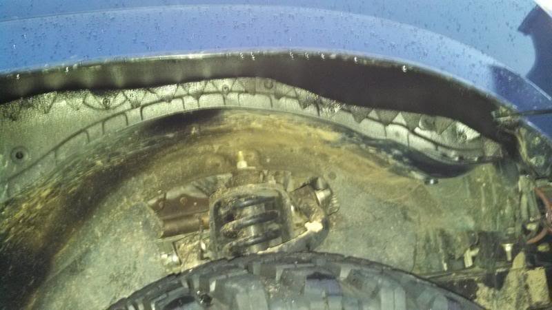

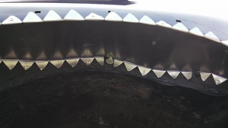

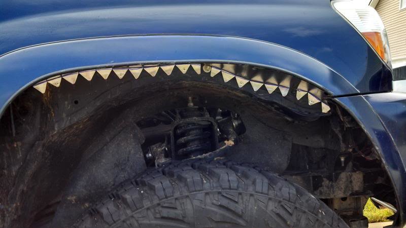

  11. Nov 22, 2013 at 3:40 AM
    #491
    MadToy
    MadToy Well-Known Member
    Nov 19, 2011
    #67334
    824
    Nick
    Huntersville, NC
    07 Midnight Blue TRD
    OME 886, Dakar leafs, LR UCA's, 16x8.5 Level 8 ZX, 315 MTR Kevlar, All-Pro sliders, BudBuilt skids, Undercoverhwms winch mount, Warn M8000 with synthetic rope, ATO Hi-Lift bed mounts, Diff locker override, Hitch harness relocated to bumper, Undercover bed cover, Gromm Aux adapter, Grillcraft grill, DT pipe bombs, Custom Magnaflow exhaust, Brute Force HC bumper, TRD Supercharger
    This took me all of an hour to do, if not less. Can't tell it's there from outside.

    ^He had to trim his fenders to clear larger tires, so that was his attempt to reinforce the wheel well. Looks good to me! Looks like it will hold up well and hopefully last a long time. :D

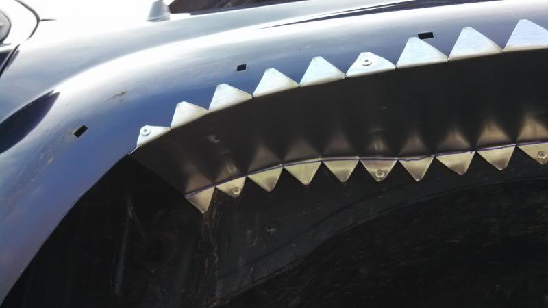

    #495
    Large
    Large Red
    Sep 10, 2011
    #63268
    22,457
    Why not try this:
    From Milowilli's build, I plan on doing this when I go to 35s and remove the liner.

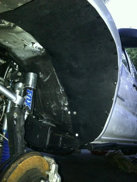

  17. Nov 22, 2013 at 9:02 AM
    #497
    92LandCruiser
    92LandCruiser Well-Known Member
    Feb 20, 2010
    #31761
    8,324
    Nevada
    80 series Land Cruiser
    Cummins, tons, 40s
    I cut up my stock ones and pieced them back in there with rivets. A couple gaps and doesn't look AWESOME but it's sure better than packing everything with shit, on and the inside out dents from rocks, those are cool too.
  18. Nov 22, 2013 at 9:41 AM
    #498
    MadToy
    Nov 19, 2011
    #67334
    824
    Nick
    Huntersville, NC
    Pretty sure that's a glass fender. But if not, would need to bend some tabs outward when cutting the fender to be able to rivet to. Not a bad way to do it.
  19. Nov 22, 2013 at 9:58 AM
    #499
    Large
    Large Red
    Sep 10, 2011
    #63268
    22,457
    It's glass, but a non glass fender would yield the same results.
  20. Nov 22, 2013 at 10:23 AM
    #500
    MadToy
    Nov 19, 2011
    #67334
    824
    Nick
    Huntersville, NC
    Not really, since you would have a gap between the fender and flare. But if the tabs on the fender get bent outward, then it may work.
