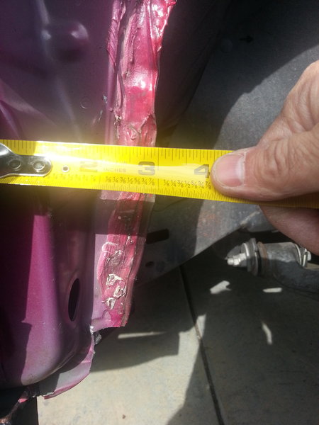

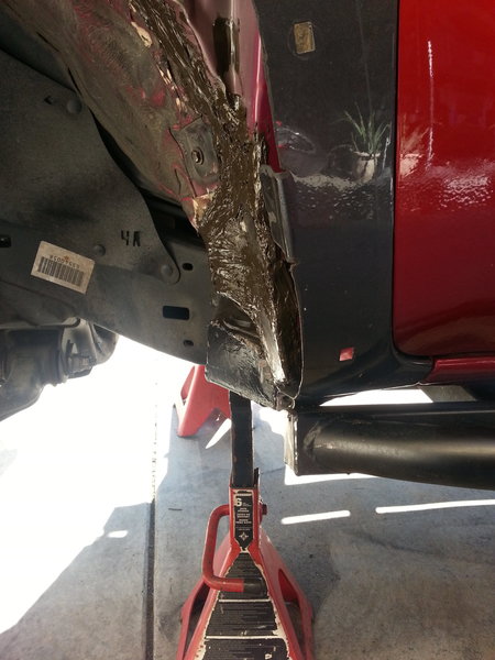

    When you guys did your firewall, about how far back do you think you went? How high up do you think you went? Trying to decide if I should just tub it.

    Sure, I cut almost 3" down low, about 2" half way up and about 1" at the top at the seam was mostly done by a little massaging with a hammer then welded it up
    Edit: about 1" of that is the pinch weld
