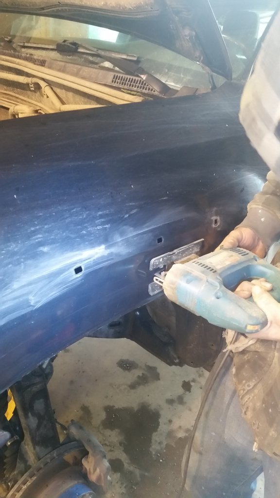

    Jigsaw ftw, used a Dremel on a few sections of the flare because I cut so much out (couldn't fit jigsaw feet )
    cut off wheel on my front, took a little bit of time. This was before I tried the jig saw method on the back.

    Jigsaw, with a grinder and cut off wheel for the front.

    I used burless metal snips and an angle grinder to get it started. It was like cutting the fender with scissors and left a super clean cut.

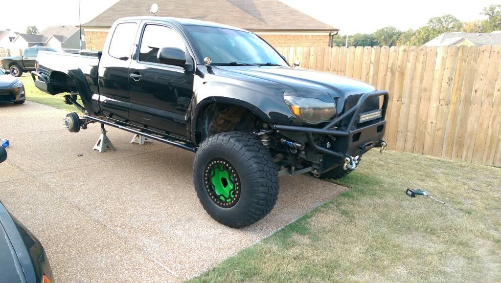

    Yeah, I wanted 5.29s. What brand beadlock are you running?
  18. Jan 7, 2016 at 9:25 AM
    #5198
    Evenflow
    Evenflow Well-Known Member
    Jul 15, 2013
    #108344
    5,766
    Jason
    San Diego, CA
    06' DCSB 4x4
    Yes
    16 is still ridiculously good / unbelievable for a 4.0 on 35's+
  19. Jan 7, 2016 at 10:19 AM
    #5199
    allmotorrex
    allmotorrex Grove St. Fab
    Aug 29, 2010
    #42441
    16,746
    Gideon
    Memphis 901
    08 SR5 4wd 2.7
    NWF crawlbox, 5.29s, rear Detriot, front Harrop, 37" SXIIs, 17x9" KMC Grenade Crawl beadlocks, Dirt King 3.5" LT kit with King shocks, Fox 12" smooth body RR, BAMF shock kit, AP 3" springs, ext. brake lines, custom 1 piece driveshaft with .135 wall tubeing, GSF front rock crawling bumper, GSF rear bumper, Relentless Fab ifs skid, BAMF k/o sliders, X2O 10K comp. winch, TP glass fenders, OKled 20"bar, EBS dimpled/slotted rotors, EBS green pads, custom K&N CAI, LCE headers, FM Super 44 w/h turn down, URD MAF, Spec clutch, LCE heavy flywheel, URD short shifter, TMPer M1 Abrams shift knob, Amsoil oil, Cobra 75wxst w/h 4' firestix, Grillcraft, FXR TRS, T1 eyelids, custom ADV Monster 60 lights, bed lights, speedo light mod, Glow Shift volt/oil pres gauges, Glow shift 2g column pod, Optima yellow tops dual battery setup w/h IBS system, Pioneer DEH-P7200HD head unit, Pioneer 600W 4ch & 350w 2ch amps for doors and sub, Wet Oakle covers
    Whoa. Calm down sir
    I drive slow
    I built them. Black rock steel wheels, 16x10 -38 offset, jester fab bead locks rings and welded everything up. 1 wheel and ring combo was shipped at #52 plus 32 3/8"x2" grade 8 bolts, 32 lock nuts and 64 washers. It's a heavy wheel and my truck rides noticeably smoother at all speeds and it's easier to maintain high speeds
