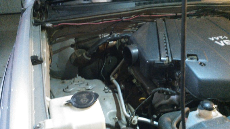

    I no longer have fender liners and also need ideas on how to prevent sucking in mist of water... I guess a snorkel is the best fix? Or somehow install new fender liners

    Snorkel is the best option if you don't mind the look of a snorkel. Still trying to figure out something not as big as stupid as a snorkel IMO

    I plugged the fender hole on my Volant.
    And fender liners made out of garage vinyl flooring (idea from NYCO):

    I managed to keep the very top portion of my liner that covers the intake pipe, it's been fine so far through a couple rain storms and water crossings, but snorkel is number two on the list after getting a spare rim and tire

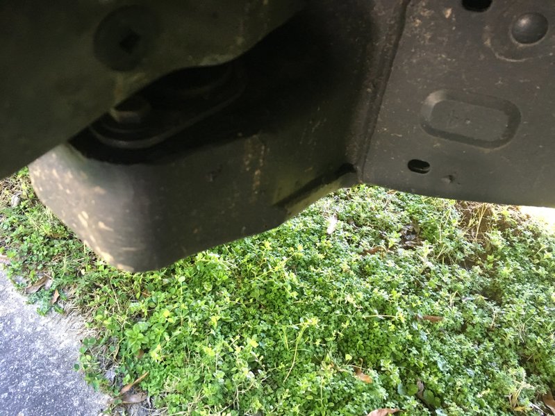

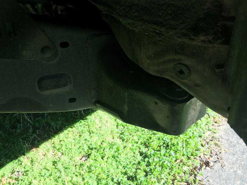

    How much more is needed trimmed?
  10. Jan 11, 2016 at 10:34 AM
    #5330
    ckeene9
    ckeene9 Well-Known Member
    Sep 20, 2012
    #87325
    10,848
    Chesterfield, VA
    '12 DCSB Supercharged 4x4 TRD Sport
    See Build Thread
    All the way back to that bushing plate.

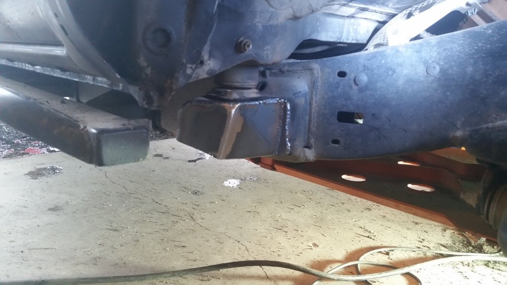

    I went full retard and left just enough room to get a socket in there just in case I need too in the future. Cut right along the mount and boxed it just at the tip

    Here's a good pic of it took it back like an inch which ended up bing like 1/2 once we boxed it in but no rubs is all that matters to me
