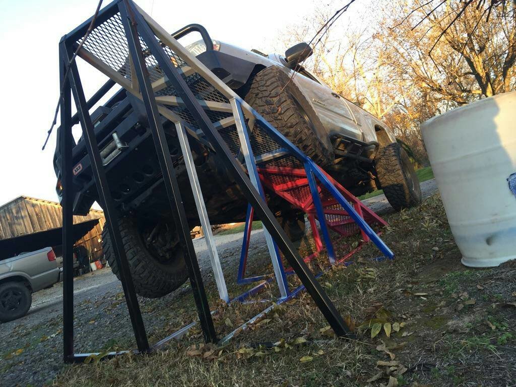

    Heres a good picture of the final bashing/chop. Seemed to clear everything but didnt get a chance to fully cycle, ill get that done when i swap suspensions.
    Who says you need a lift to fit 35s :rolleyes:

    Yes you can do this. It's a very effective way to find out if you rub anywhere. Spray paint everything real quick then you'll rub off the paint where you rub

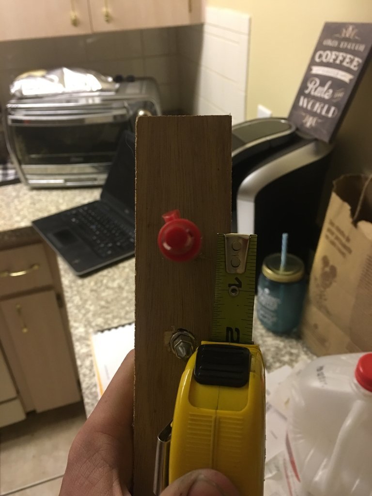

    Hey guys quick question, got the OME for the front to be installed in 2 weeks and Chevy swap in the rear, ordered my 315s today. Took of 1.5" off the flare and plan to do the same with the fender, do I need to do more?

    I believe most of us chopped a minimum of 2"

    General consensus seems to be 2-2.5" off the flare and fender iirc.

    Yeah I would do atleast 2"-2.5"

    I took 2-1/4" out of the sheetmetal fender and 2" out of the plastic flare, so the cut edge of the sheetmetal is somewhat hidden.

    I measured the cut pieces and they measure 1.75, however, I melted quite a bit with the dremel, my marker is right at 2" 5f0ebbf3cbe329ce32172b130b39d81e_d8eabfe2d308617f87772324a070c133ea115579.jpg

    How tall are the flares without being cut?
