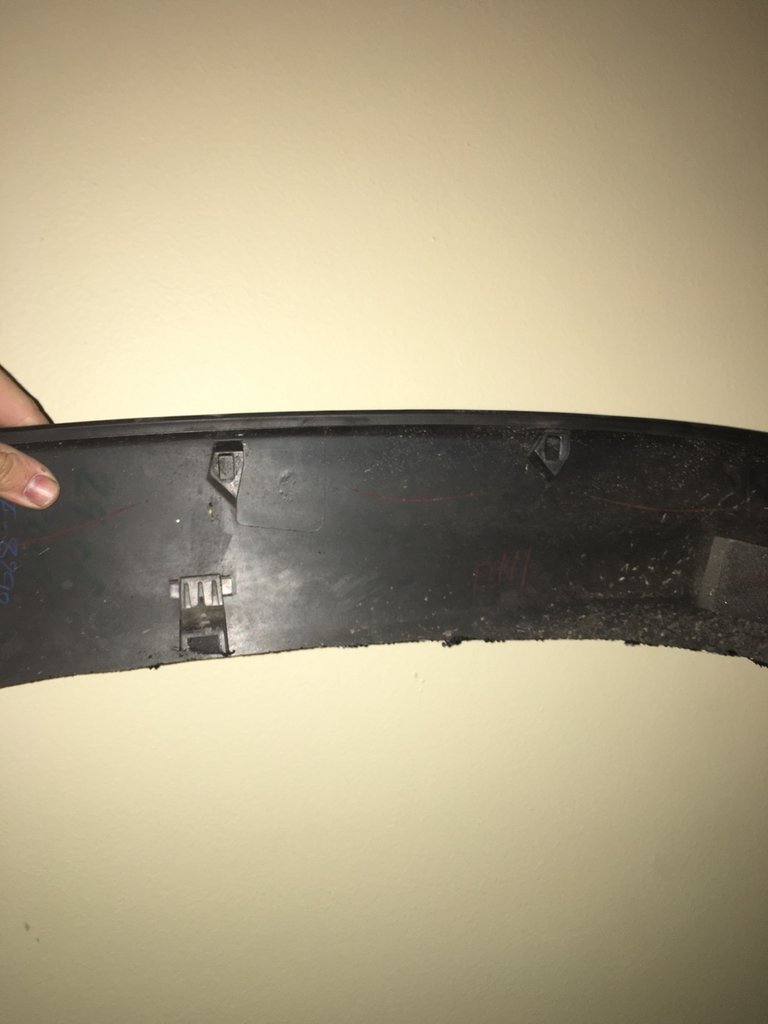

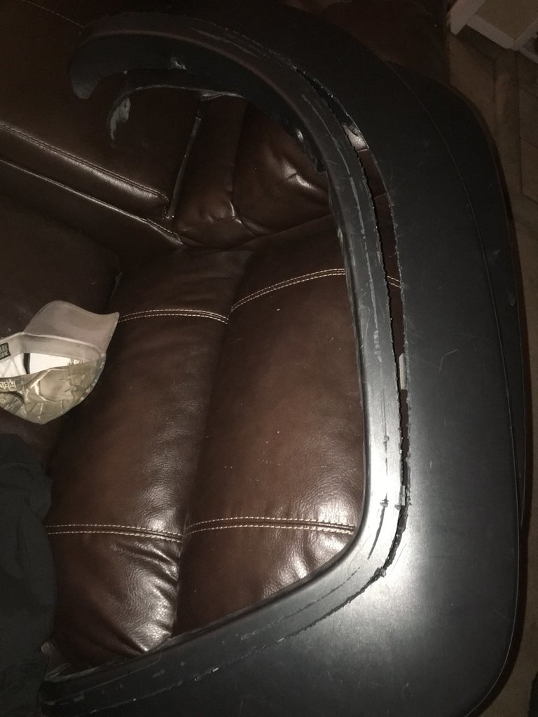

    No idea, looking at it I realized I cut then sanded so that makes up for the half inch so I'm at 2" off on the flares
    Acerwin[QUOTED] likes this.
  2. Feb 6, 2016 at 12:49 PM
    #5582
    deeezy
    deeezy Well-Known Member
    Sep 1, 2013
    #111645
    5,253
    Dana
    Hawaii
    2013 4x4 DC, 6 spd, TRD Sport
    King ext travel coilovers, Icon tubular UCA's Rear-King "Tundra" 2.5's, Allpro Expos, TRD cat-back, Hurst/Core short shift kit, etc...
    You need to configure your tool so that your cut pieces coming off are 2". If that red thing on your tool is what is sliding on the edge of your fender, measure 2" from the edge of the red wheel to the center of your pen.
    TAZ2014Taco[QUOTED] likes this.

  4. Feb 6, 2016 at 12:51 PM
    #5584
    TAZ2014Taco
    TAZ2014Taco Well-Known Member
    Oct 26, 2014
    #141109
    2,266
    Florida
    2019 Tacoma 3.5 SR5
    Didn't see that til after, all are complete now and smooth. Tomorrow I'm doing the fenders. So general consensus for the fenders is 2" as well?

  9. Feb 6, 2016 at 12:57 PM
    #5589
    TAZ2014Taco
    Oct 26, 2014
    #141109
    2,266
    Florida
    2019 Tacoma 3.5 SR5
    Are you planning to cut flares off the top? I don't see how they would in mine since the clips are gone now :/

  11. Feb 6, 2016 at 1:00 PM
    #5591
    TAZ2014Taco
    Oct 26, 2014
    #141109
    2,266
    Florida
    2019 Tacoma 3.5 SR5
    I'm confused lol I don't see how the stock clips will work since when you cut the flares, the places where the clips were get cut off

  13. Feb 6, 2016 at 1:01 PM
    #5593
    deeezy
    Sep 1, 2013
    #111645
    5,253
    Dana
    Hawaii
    They are goign to be hanging on by the top clips that are left.
  14. Feb 6, 2016 at 1:01 PM
    #5594
    TAZ2014Taco
    Oct 26, 2014
    #141109
    2,266
    Florida
    2019 Tacoma 3.5 SR5
    Aha! I see now I am an idiot

  15. Feb 6, 2016 at 1:03 PM
    #5595
    deeezy
    Sep 1, 2013
    #111645
    5,253
    Dana
    Hawaii
    That's another reason why it's good to cut at least 2" off. So you don't have a heavy flare hanging on by only the top clips.
