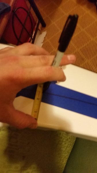

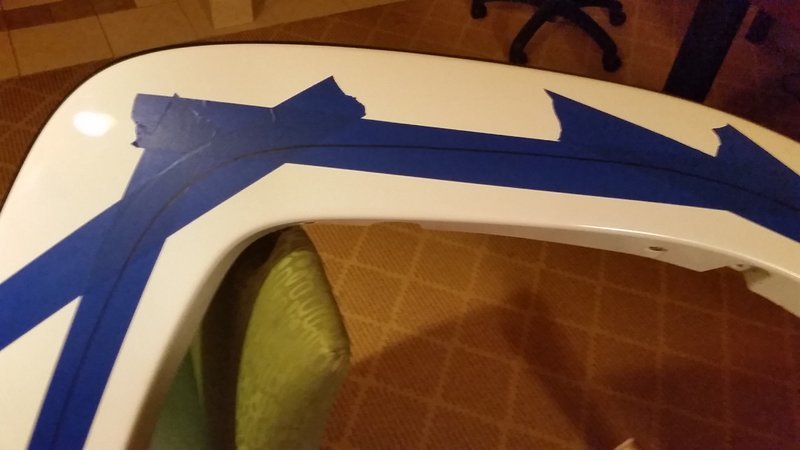

    Hard to see but i have my cut line drawn out. Did it a super easy way. One narrow tape measure (the kind the sell for key rings) and sharpie obviously. I just put the clip of the tape on the edge of the fender and held it down then kept my marker against the edge of the tape where i wanted to mark. Just move it along and it makes a straight smooth line. Obviously use one hand holding the tape against the flare and the other holding the marker (not like the picture :rolleyes:)

    Ready to see how it turns out

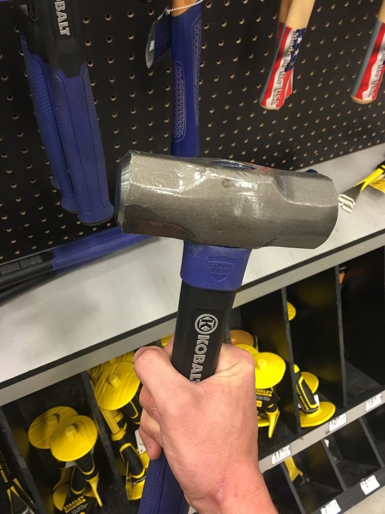

    Will a 4 lb work for pinch weld and firewall

    That's what I used.

    It's a good start. I went to a full length 10# later on though.

    Sheesh lol maybe I'll pick one of those up next.

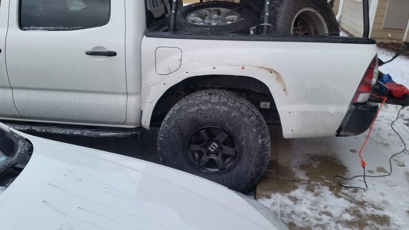

    Trimmed all the flares today and followed evenflows advice to go ahead and cut the fenders. Figured since i already had the jigsaw out. Offroad bed outlet ftw.

    Edit: ill get a better picture of the other side when i get off and ill have service to upload
