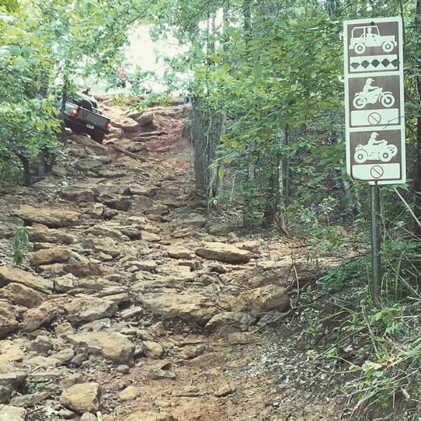

    Its a good time when we wheel lol. Honestly surprised I haven't broke anything yet!uploadfromtaptalk1456711150203.jpg
    Thankfully a different company got the bid on that job so I never had to head up there actually lol! But I'm down to wheel wherever if I ever make it that way.

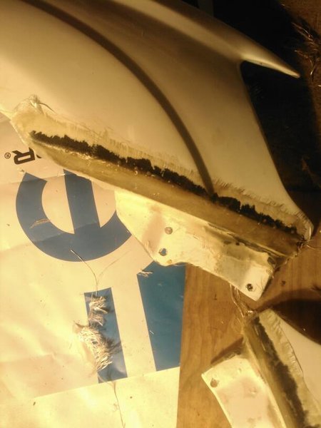

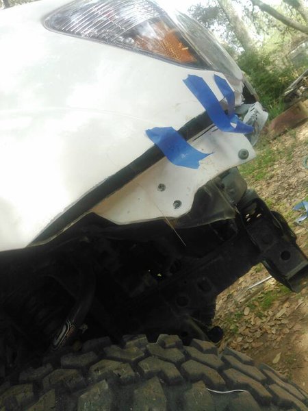

    Pretty shitty honestly. I couldn't lower the bumper enough to have any space between the fender and bumper so I literally cut out 3/4" from the fenders and re-glassed em. Now I have about a 1/4" gap. I know its not the ideal 1/2" gap but if they make contact and crack then I'll just refiberglass them again. uploadfromtaptalk1456713416807.jpguploadfromtaptalk1456713425725.jpguploadfromtaptalk1456713481728.jpg
    I haven't taken an after pic yet so this is just the before picture (with no gap) and the modifications made.
    I couldn't move the fenders up enough or the bumper down soooo this was my only option really.

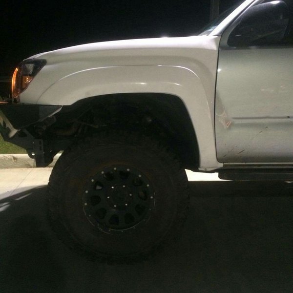

    Here's a pic from the night I got em mounted without any cutting. You can see they're wider than the bumper and how the gap is uploadfromtaptalk1456715547033.jpg

    Thats pretty damn good fitment right there...But to the point a little to good...these are the 2 inch flare right? You didn't want to go 3?

    Correct. 2" flare 1" rise. No sir I didn't want to go 3" because I enjoy the lower(as less wheel gap as possible) look with plenty of down travel.
    I have solid axle plans and they include bumpstops before hitting the fender so didn't need 3".
