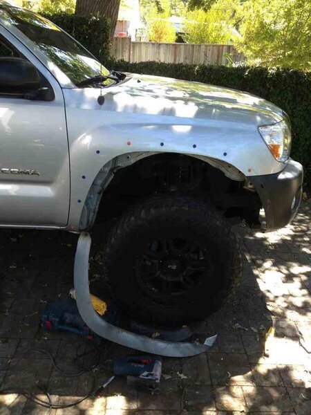

    Air powered body panel saw. Cleanest cuts.

    I used a jigsaw and angle grinder at the bottom.

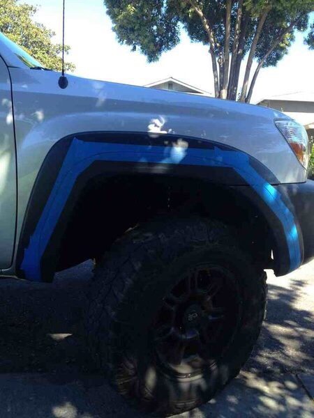

    i used flexy flares and line-X

    That pinch weld is a fckn bitch. Just snapped the handle on my stupid little sledge.....Maybe I'm the bitch, dammit

    Did you just go after it straight away, or did you cut it every two or three inches to make it a bit more manageable?

    I just went at it. The top/thinner part went easy. Bottom was where it went down hill.
    Now I know. Cut that shit first. Now to buy a new hammer.

    Just go at it, don't cut it. Cutting it introduces more ways for it to leak.

    Yep, I just split the difference on the thick part and beat the 2 sections down.
