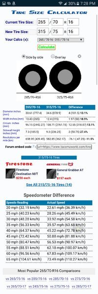

    Use the Tacoma World tire calculator if you are automatic. Just make sure you use the stock tire size that came with the truck from the factory.

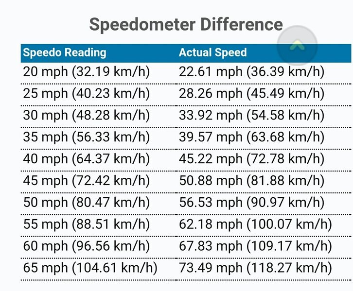

    Not sure why the first pic res is crappy. I adjusted my ultra gauge based on these numbers and checked it with satellite from three different sources, and it was spot on. I imagine it changes ever so slightly as tires wear, as well as speedos are allowed to be off anyway.
