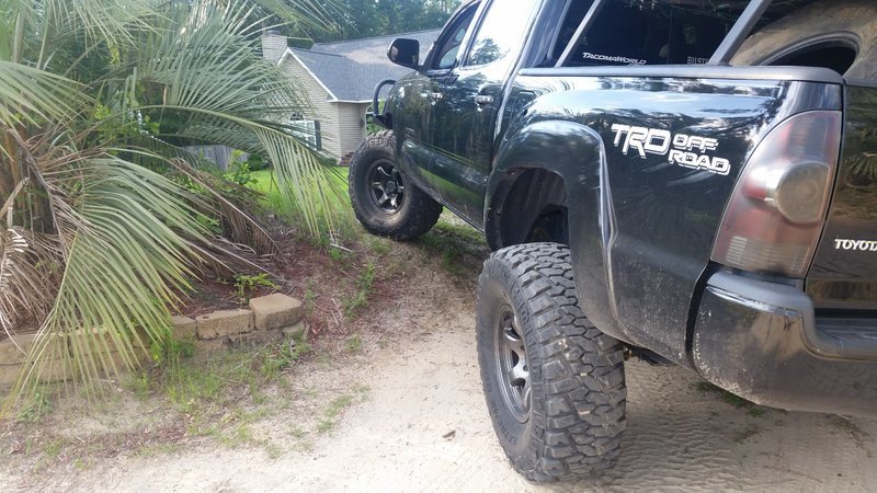

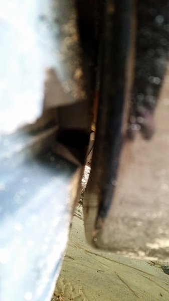

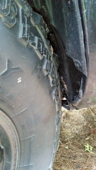

    20160609_191254.jpg 20160609_191308.jpg 20160609_191434.jpg rear flares clear but up front I need to beat on the fire wall and pinch weld a lil more. Also need to trim or roll the fender lip a lil more.

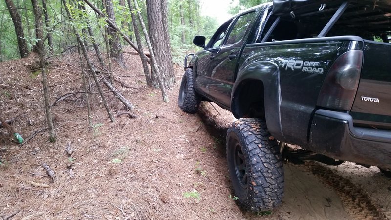

    20160609_191243.jpg all clear if I stay in a straight line lol full flex in all the pics

    In that first photo is your rear axle on the bump stop ? There is no way at full bump you are not smashing the rear flare with a 35" tire. I have 3" cut out of my flares and fenders and my tire tucks up inside that at full bump...your saying full bump is like 3 or 4" lower on your truck ? Not trying to be a dick...just trying to keep you from destroying a flare and crushing your bedside out on the trail.
    As far as the front end goes you need to pull your CO out put the wheel back on and cycle the suspension with a jack with the wheel turned to lock to really see the gruesome truth ...again I really don't think you are seeing full bump...everyone else on here with 35's has chopped fenders and flares...
    My 35's tuck this far at full bump and I cut another inch out of the flare and fender after this photo because when the axle articulated it still caught the bed side and crunched it :

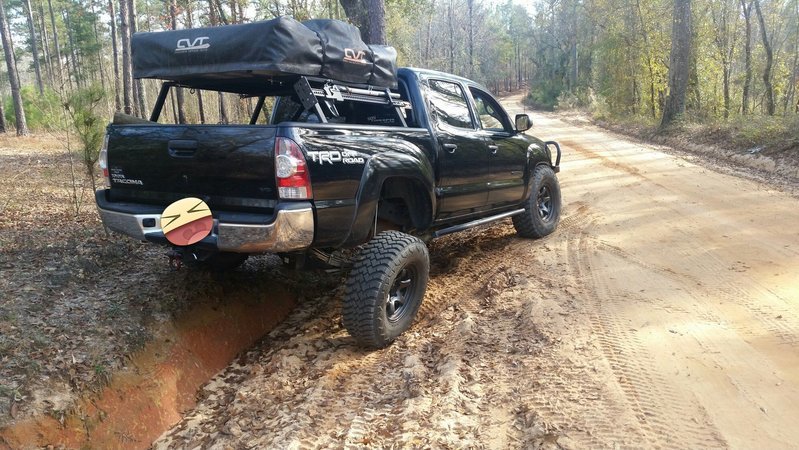

    Yeah I was on the rear bumps. Yeah that would show everything. I know if I was to flex going down a hill I'd be tearing my fenders off in the front. Here's when I had the 295s stuffed not the greatest pic but you can see how close I was to hitting the top fender up front.
