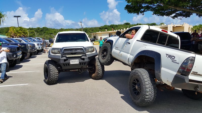

    The guy in the single cab stuffed 37's and is at the same height as me. It looks pretty dope, but too big for me. 35's on a 2.5-3" is perfect.

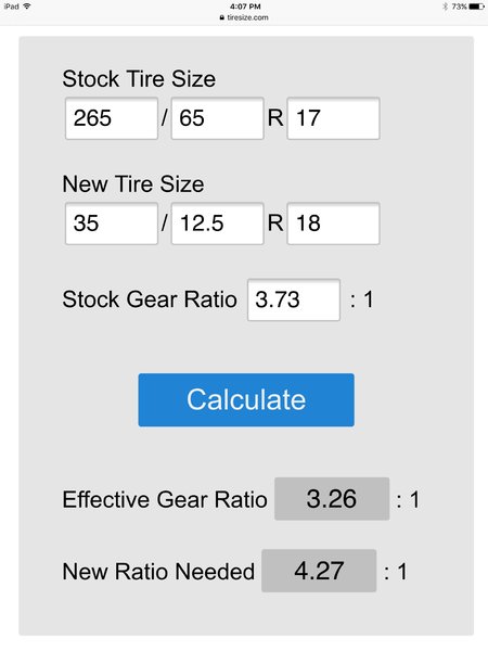

    Has anyone done 4.10s in the V6 auto yet? I got a set of 4.10s for next to nothing I'm gonna drop in when I go 35s in the next couple months

    Someone here did 4:10's I remember them discussing it but...Technically 4:10's would be under geared still, you need 4:27's to break even :
