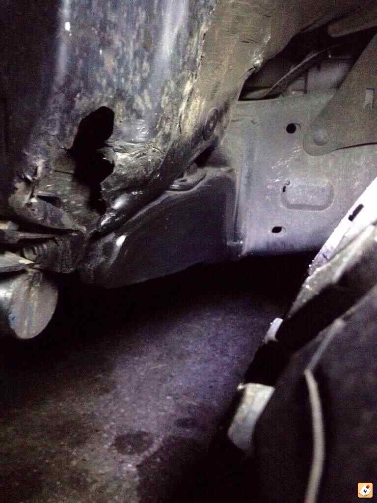

    I finally had my body mount chop plated. I still need to plate the firewall though

    I am rubbing on my frame at full lock and my UCA's rub just a smidgen too with slight up travel. I am going to get a set of 1.25" wheel spacers to solve this problem.

    Ball pien hammer ?

    Obviously, it depends on your rim, but just remember the further out you go the more clearance you will need for the cab mount and firewall.

    Seems like everyone rubs in different places. My rims have 4.3 BS and I clear the cab mount and UCAs but rub frame a bit at full lock. Will need to hammer in passenger side pinch weld a little more as I rub slightly when stuffed
