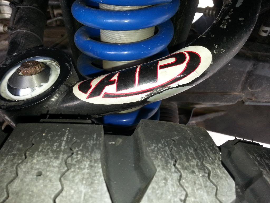

    It really seems that somewhere between 4.25 and 4.0 is perfect. Ohhh well.

    I think mine are 4" bs

    Don't think so. Haven't seen any rub marks and when I was clearancing, had the coilovers out, steering rack disconnected and bump stop damn near squished and never hit frame or uca as I turned it left and right

    4.0 bs and I just barely rub the frame at full lock.

    Pulled the spacers and I am all over my UCA...no u turns for this guy till the BORAs show up...;)

    Don't mind all my ball juice. Just cleaned them out and relubed after tossing metal shavings everywhere from grinding the cab mount.

    That's exactly what mine looked like with my 4.5" BS. The 1/4" spacer eliminated it.

    Went over and picked up 1/4 spacers just as a stop gap measure till the BORAs arrive...no go. I didn't have enough threads showing. FJ rims are thicker than the Tacoma wheels it seems.

    I have extended studs in my hubs.... :eek:

    And now it makes sense...I couldn't get them in there. Ohh well I tossed the spidertrax back in up front. Good news is that since I have been making room for the 315s with the spidertrax in there I am going to be free and clear with the .75s now :)

    I run 4.5s and spidertrax no issues

    I had cleared everything out for it already but it was way to much swing arch for what I needed and will allow good stuffing in the wheel wells.

    Not going to lie, I had to make a lot of room. Or at least a lot of noise to get them to clear

    Ohhh me too. Cab mount is basically gone and my firewall hates me...and once I got it mostly cleared out I realize that it shouldn't be that hard with the right BS...
