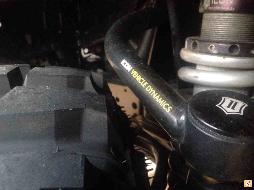

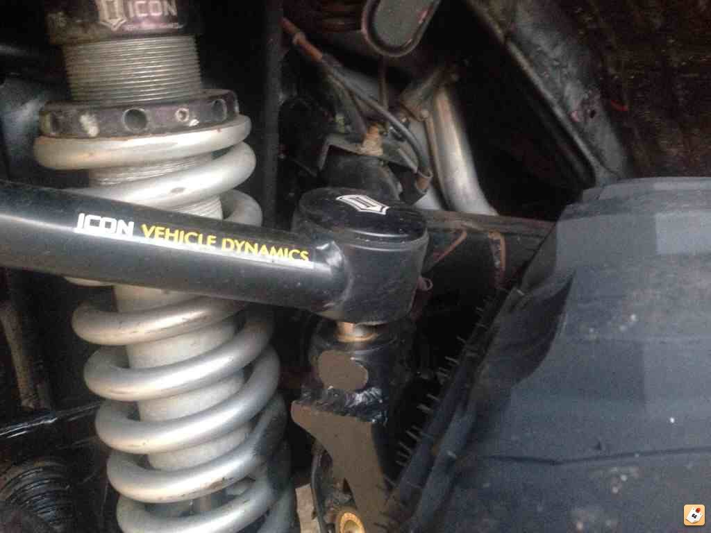

    ANyone running the ICON Billets? Curious on backspacing

    Those LR ucas also throw in a curve ball...since you can essentially kick the ball joint away from the uca and create more room. I was actually looking at swapping to those just for that feature.

    Probably depends on the tire to because brand a might be wider than brand b or taller/shorter. I think that guy did a lot of research on wheels and tires or got really lucky it all fit that way on that particular truck.

    Thanks Ryan. That is a great fit! Wish mine were that nicely fit in there at 4.3BS...I also luke those uniball covers.
