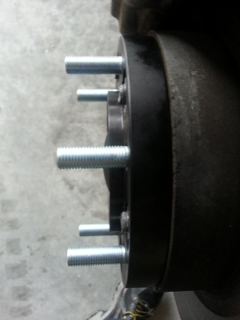

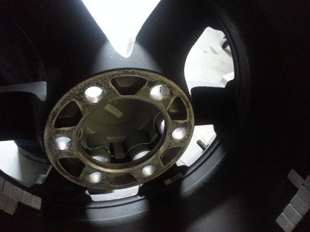

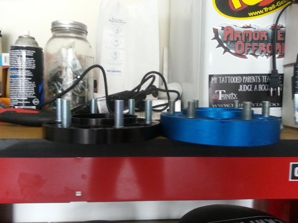

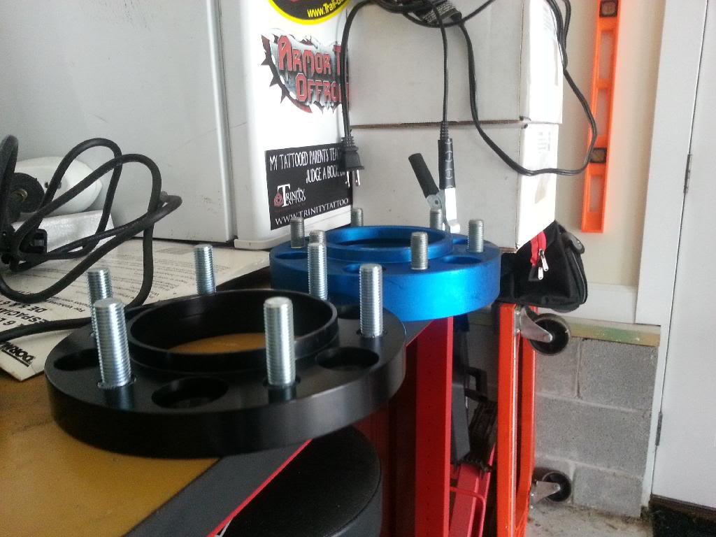

    Thought I would share some spacer tech...
    Here is a .75" BORA spacer next to a set of 1.25" spidertrax spacer. Notice how long those new studs are! Schwing!
    Mounted up so you can see that the stock studs don't quite clear...
    And the back of the FJ Trail Teams Rims and the nice little pockets that keep me from having to trim the studs.
    End result is that I just kiss the UCAs at full lock and have made a nice gap while turned up into the firewall and cab mount. Much happier with .75 spacers.
