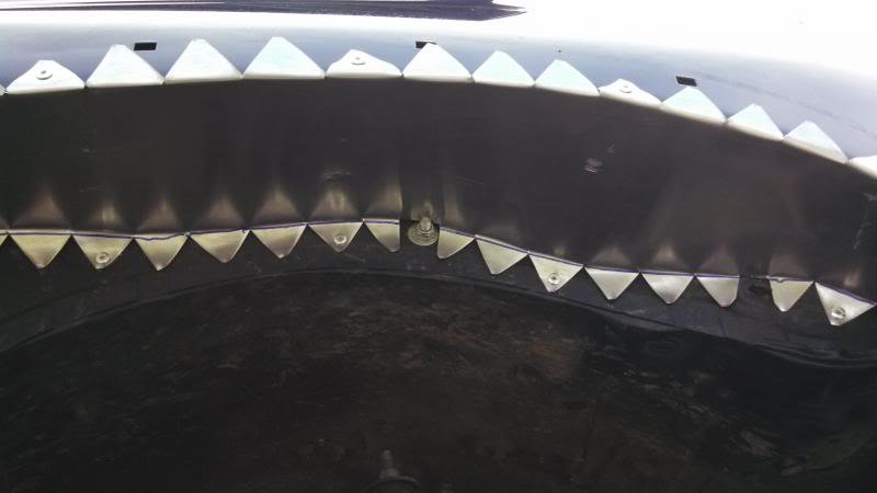

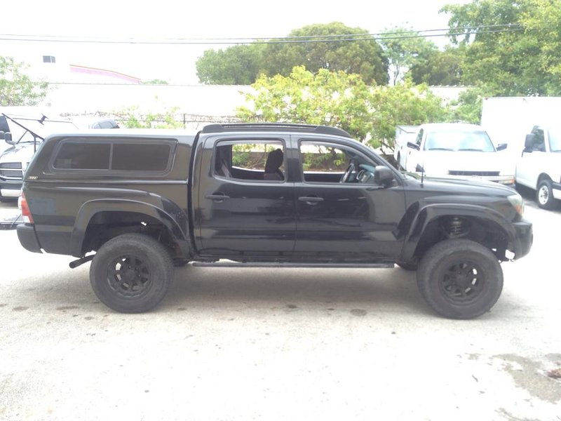

    Just finished my flares, fenders, pinch welds and cmc, took 6 hours non stop. I'm happy with it, I'm going to reinforce the fenders a little they flop in the wind a little bit. I'm happy overall here's what they look like with 265/70/17. 315's get put on tomorrow. 2in cut all around.

    Looks good:cool:

    Thanks man, can't wait to see what it'll look like tomorrow. Hopefully I chopped enough of the cab mount

    Eh, get enough off the cab mount to mount the tires. You will be cutting more and beating the truck with a hammer again.....you have only done the minimal stuff so far....

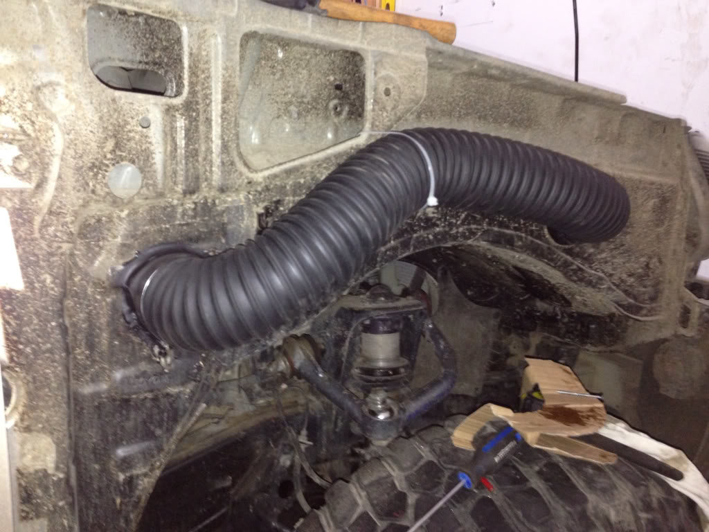

    Into the cab for me, my exhaust is way louder than the intake so don't have a problem with it.

    Yea figured as much I'll try and find a spot to really get a good flex and mark some more spots to cut and hammer

    There mounted! Add me to the list!! just have to finish the door trim on the fenders. It rubs the uca at full lock a tiny bit. I think 3/4 spacers should do it. Can't wait to get out and wheel

    good work man looks nice
