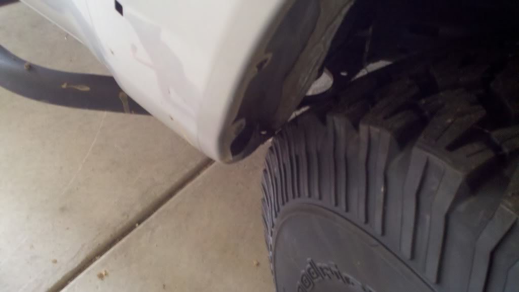

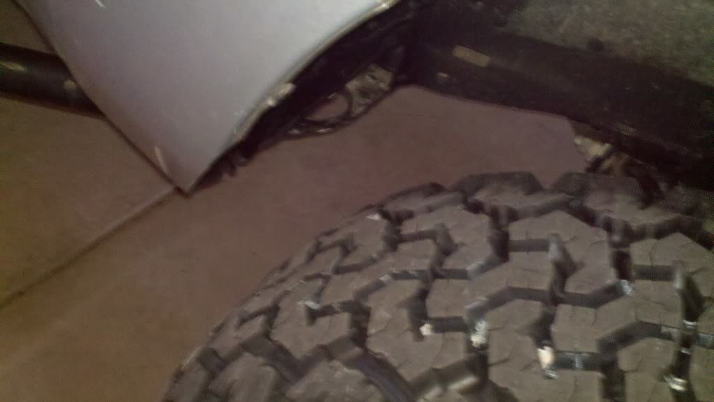

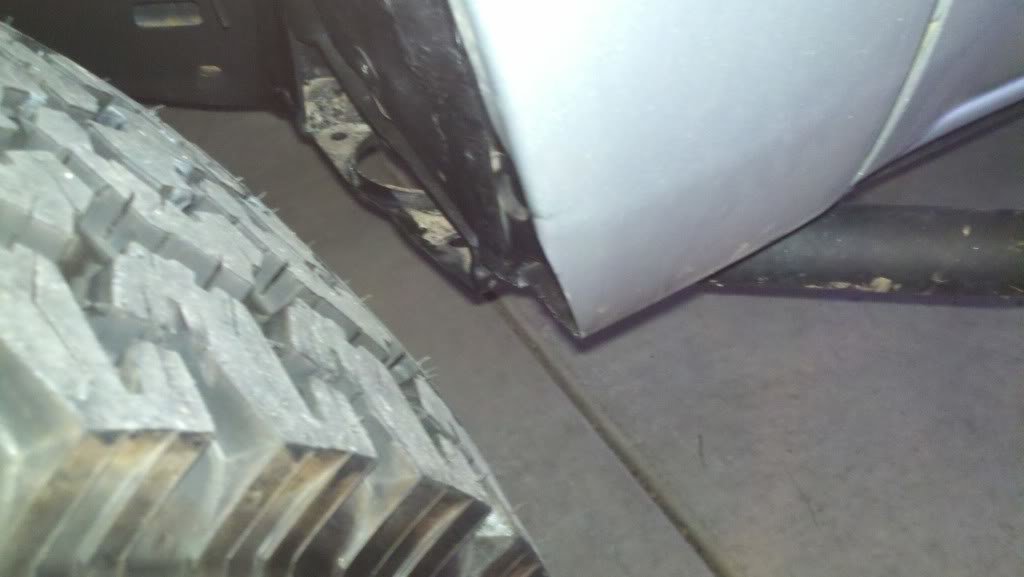

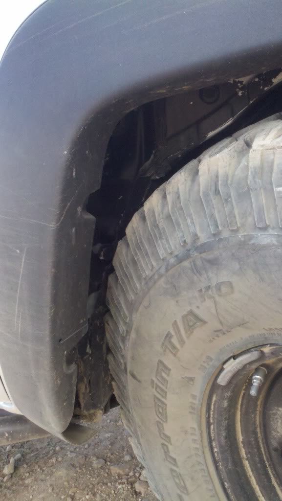

    Thanks battle, but going 35 with a 3" lift the cab mount needs to be a bit more cut. Your picture did help me some though :cool:

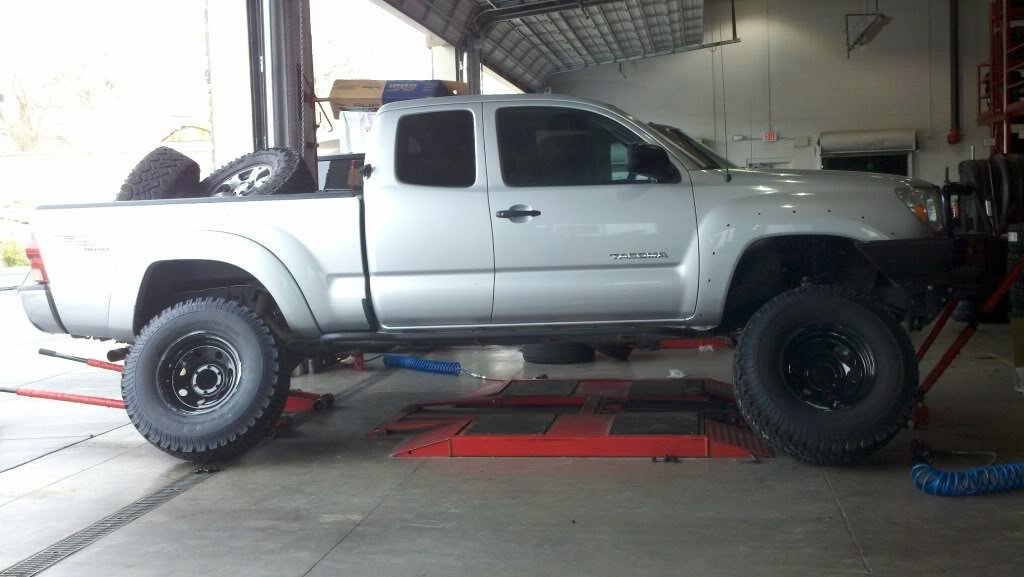

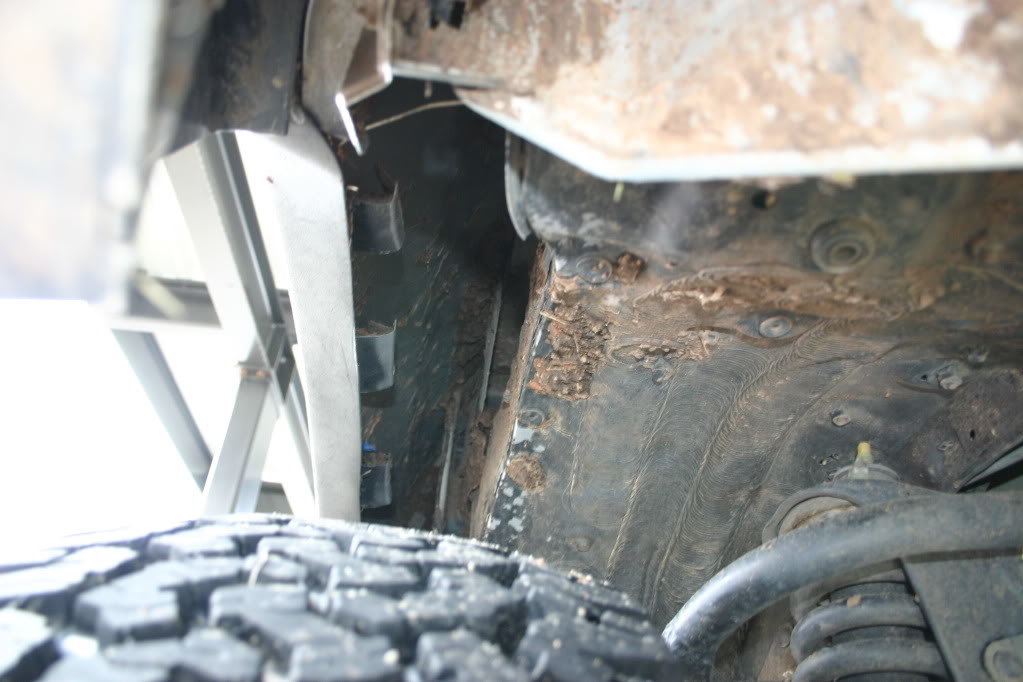

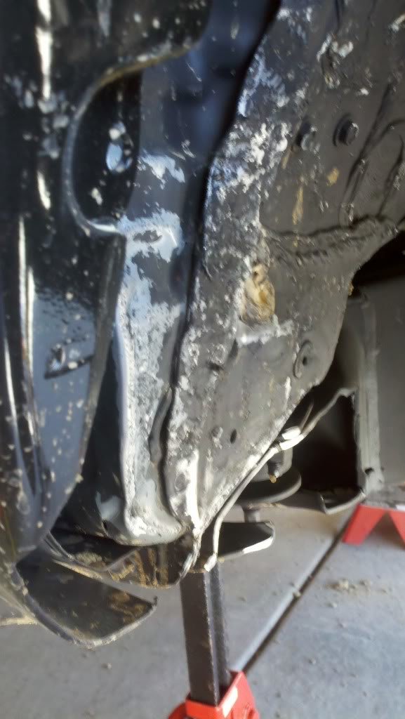

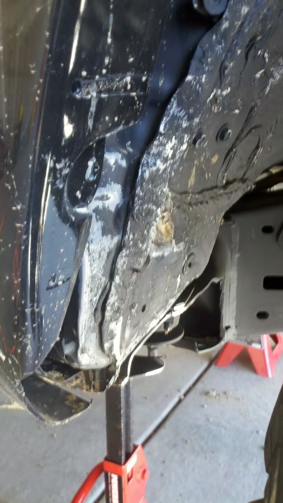

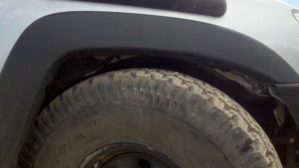

    Various stages, in no particular order, I've clearanced more since...

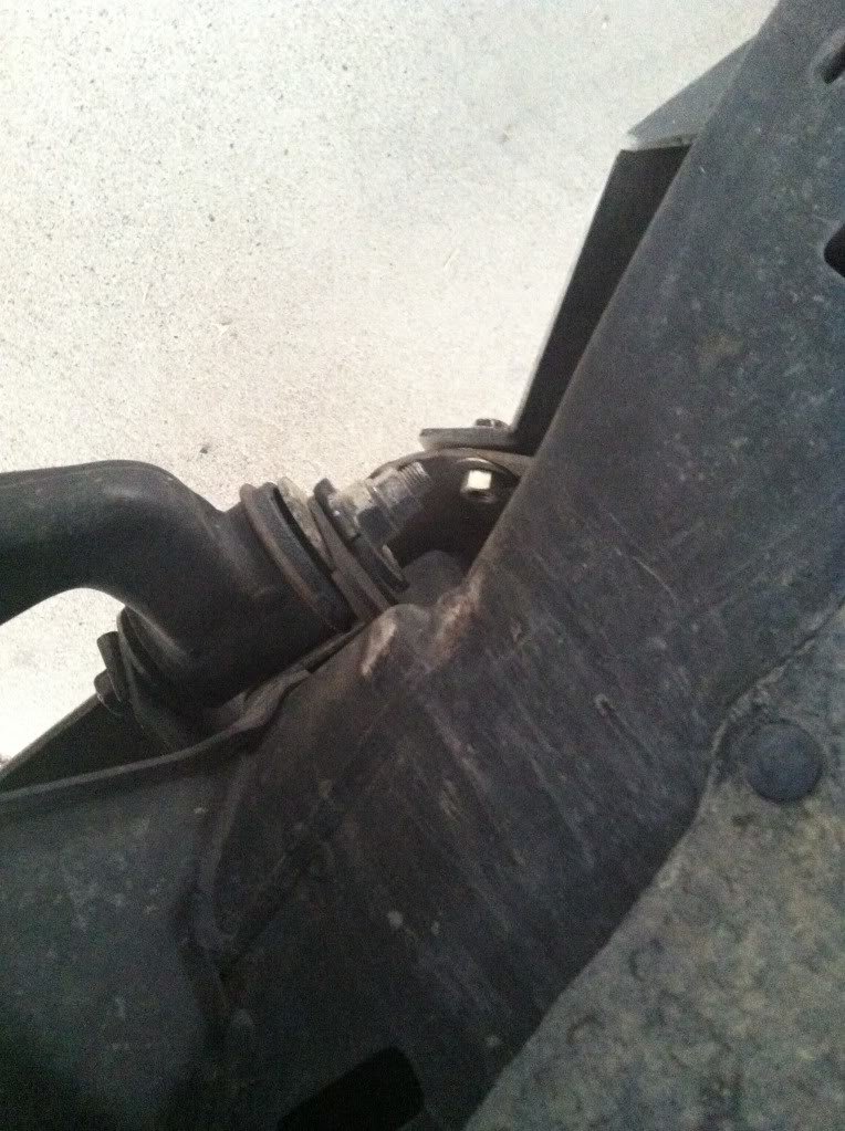

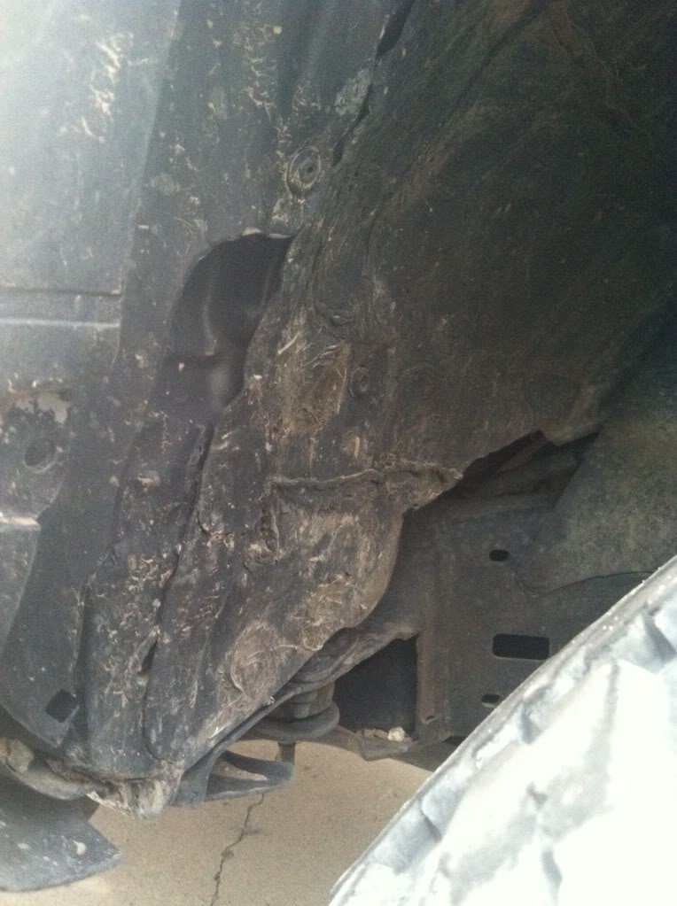

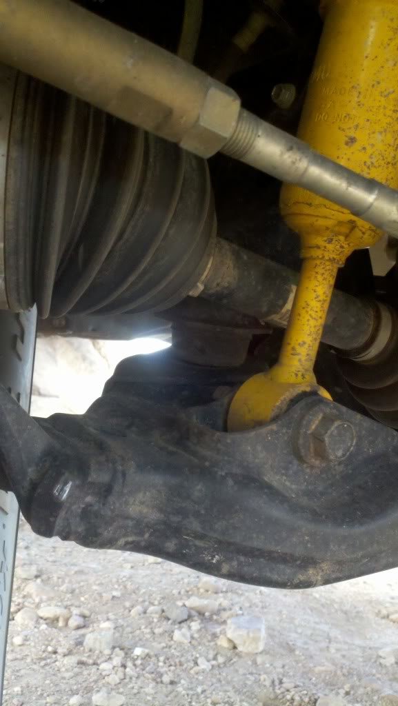

    Here's what I was talking about earlier.

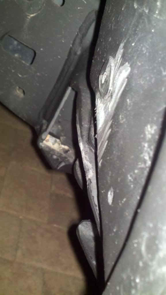

    My only frame rubbage, no UCA or LCA contact with my setup.
    Also noticed my mid skid was about to fall off the IFS skid lol, 2 of 3 were loose and the last the nut had rattled off and was lone gone and the bolt was just hanging there. Good thing I took that picture!

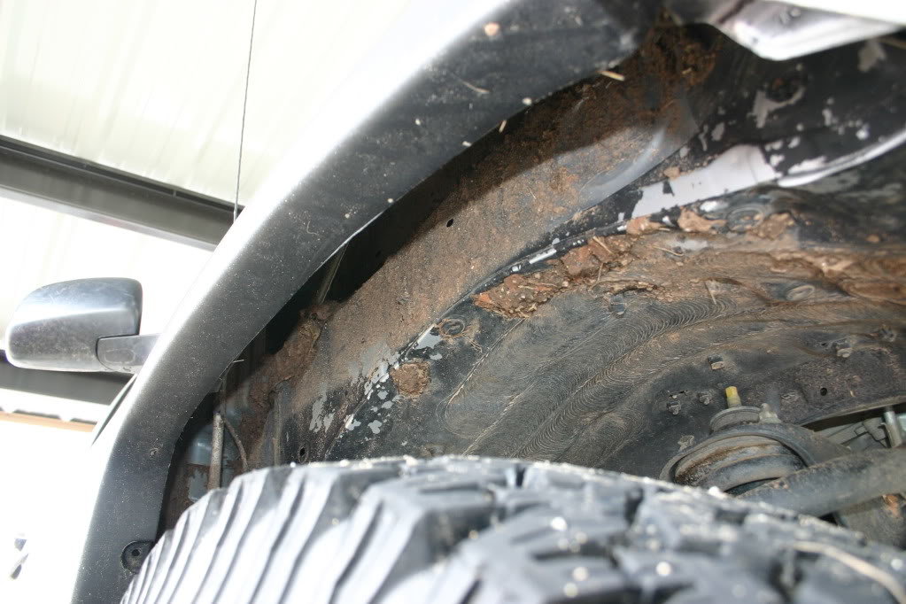

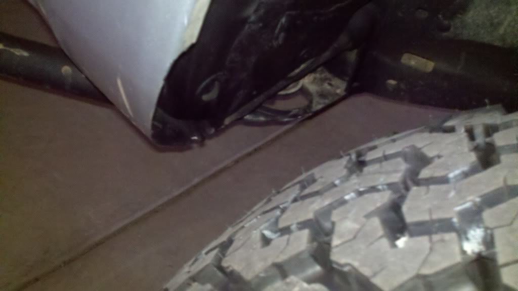

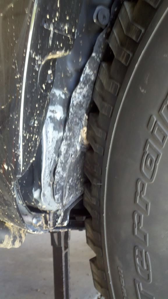

    and here it is as of today, might be hard to tell but that firewall is smashed back a lot, on the driver side I had to beat it back the other way because it interfered with my clutch pedal. Also tore the sheet metal in a few spots, sealed with RTV.

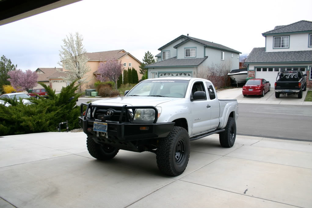

    Friend of mine
    2" LT, 35's, cut fenders & flares.

    Absolutely Beautiful!

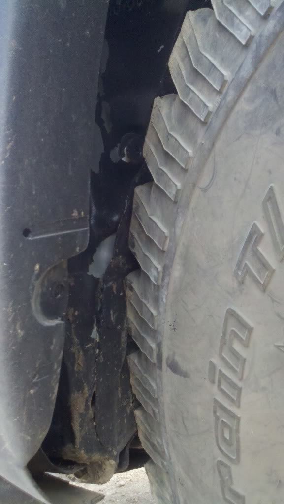

    Did you ever get the rubbing on the UCA resolved? I did a test fit yesterday and rub mine pretty good!
