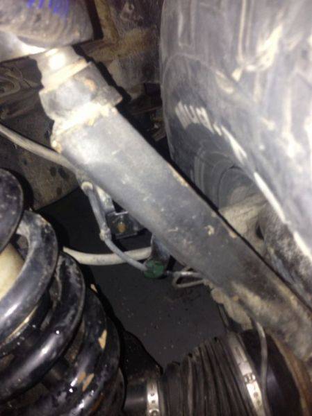

    Here are total chaos non sway bar spindle gussets, with a 4.5" backspace wheel.
    Tons of room between the spindle and wheel. Could probably fit 5.25" backspace wheel
  19. Feb 16, 2014 at 3:39 PM
    #1299
    VanCity4x
    VanCity4x Well-Known Member
    Aug 1, 2011
    #60970
    1,411
    AB
    05 Tacoma
    3link on tons
    Cool. That might work. What size rim, I run 16, would make a difference with 17.
  20. Feb 16, 2014 at 3:41 PM
    #1300
    Reeeno403
    Reeeno403 hammerdownson
    Jan 1, 2013
    #94165
    662
    Calgary
    06 Tacoma
    Not a Stocko Taco.
    ^^^ Thats on a 17
