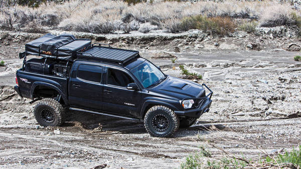

    Check the build thread.
    I haven't geared my truck yet - gears sitting in my garage waiting on the ARB lockers to come in to be installed - but with the 35's on and loaded up, keeping the speed around 70mph I am getting around 13-14mpg. Around town 15.5mpg. My speedo/odometer is off of course. Going off the mile markers my truck reads 1 mile at like 1.2 miles.
    I am going with the 4.88 Nitro gears.

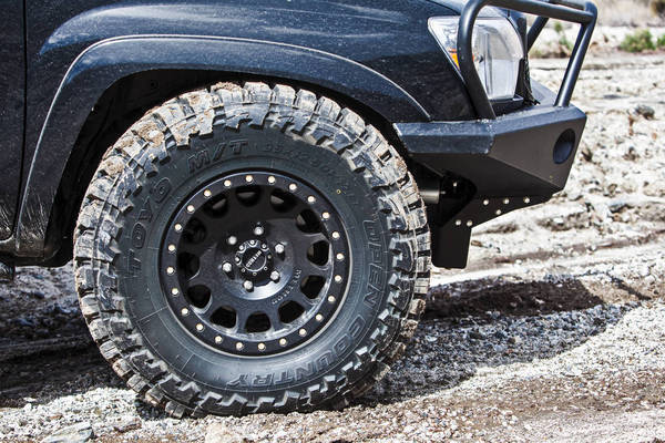

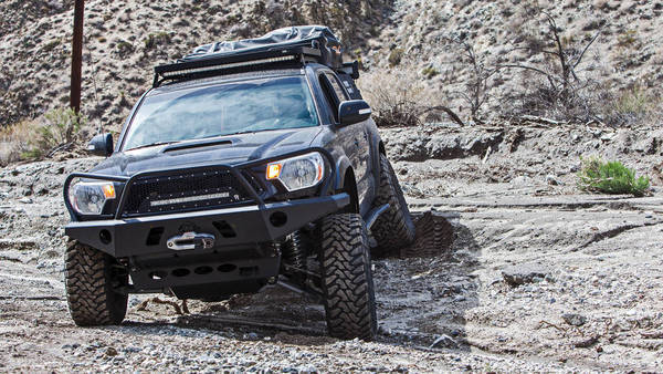

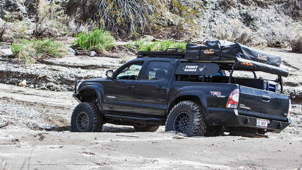

    As for the clearance issue with 35's and 3" of lift..
    I am currently at that same set up but I am running an All-Pro +2 long travel kit so clearance is a lot easier. I have had to hammer in some areas and trim others but nothing extreme.
    17x8.5 Method Race Wheels 105 series Beadlocks 4.75" backspace
    Just took this today for a guy wanting a side profile:
    Testing the clearance - with the tires turned I will rub in a couple areas but wheels straight I am very satisfied.
