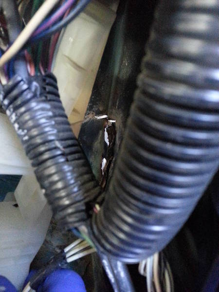

    Defcon, thanks for your input. I will be looking to get a +2 LT kit in the future...
    Word of warning careful when cutting the pinch welds... mine were notched then folded, then grinded a bit. But after my last desert trip I split the seams and water gets inside on the floor! :eek: Should have welded it like Wishbone did! Could have avoided this issue!
    Add that to the list of the over-haul items. :rolleyes:

    I folded mine back with a big set of pliers a little at a time. That is one flimsy piece of metal. I thought it was going to be hard to bend. The only hard part was at the bottom. Once I got it bent over I used a big smooth piece of metal (see picture) and hit that with a hammer. It took me longer to jack up the truck and take off the tires than the whole pinch weld process. No power tools used.

    I may have to make a trip to go see Jerry. lol weld mine up.

    Wow! My welding the way it currently is will definitely leak, but it is under the truck and no electronics in the vicinity. If I were to do this in the front, I probably would have taken more time to prep and be a bit more careful, and then for sure spray with liner to keep the elements out. I think it could be done though, and haven't seen anyone else take this approach, so figured I would share.

    You can always slatter on some RTV over the entire thing (I did this up front) let it dry and then paint it. Sealed! :D
