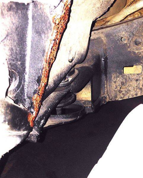

    I went by BAMF, Jerry welded it up a bit to fill in the holes and I'll add some sealant to fill in the rest. then paint it. Then Bedliner it. lol

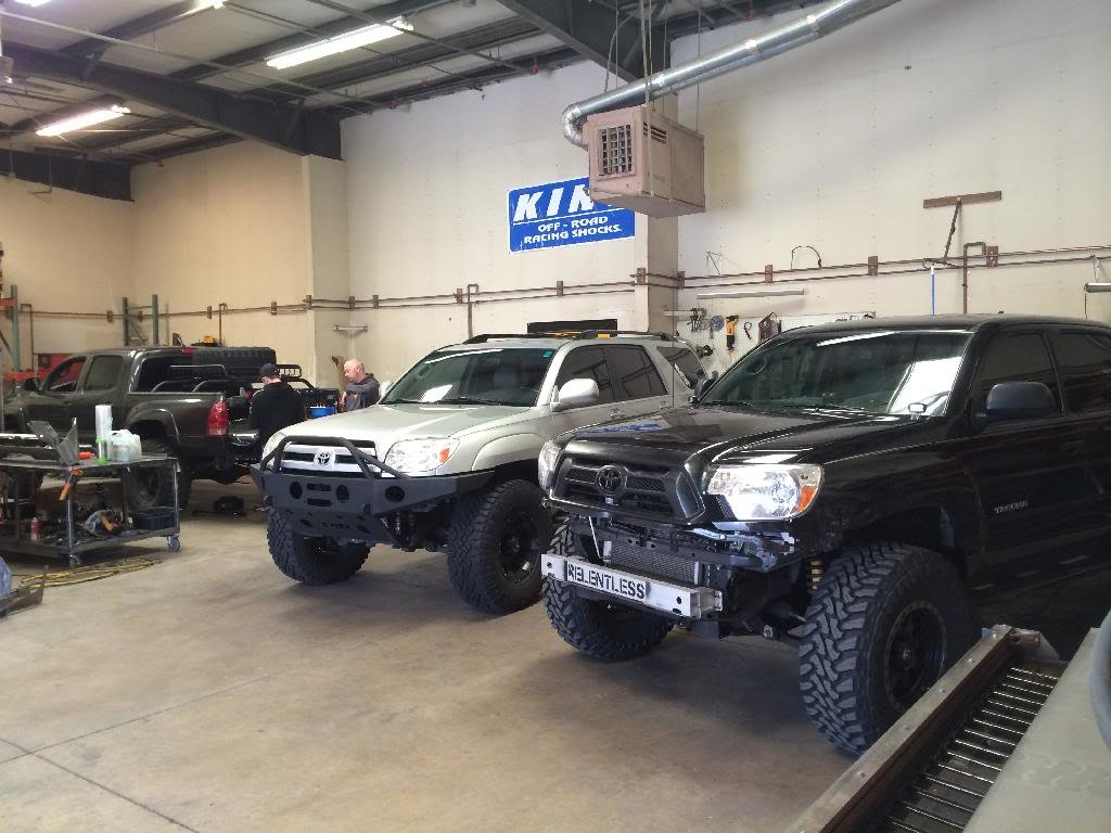

    35's fit like on 4th gen's they do on the 2nd gen Tacoma's, for the most part(washer bottle is an issue, and a little bit of rear fender on compression on the 4runners):
    All 3 rigs in this picture are on 35's and 2-3" lift
    9C5F5711-6E0A-4B19-A789-DFD264B21721_zps_fcf7231048868212f925662e5e7debdd525c5586.jpg

    I used the same stuff. It dries out a bit after a while and will leak again. Best to fill the holes with clear RTV first. When that cures, then put some layers of the rubber sealant over it.

    I used some clear stuff for the bigger crack. The smaller side I just used this. In the future I think I'll just cut the whole fenderwell and redo it. lol
