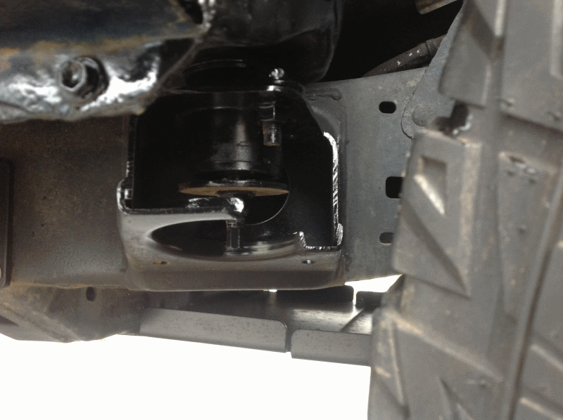

    Cut as much as you can off the body mount up front, and save the headache of having to do it again later. This is before I 'boxed' it. I actually used 3" diameter pipe to box it up and maintain a small profile.

    Ok - here is a crappy shot. And ignore the welds! My POS HF welder was crapping out on me. I'll fix it once I get a real welder :/

    That is genius!!!

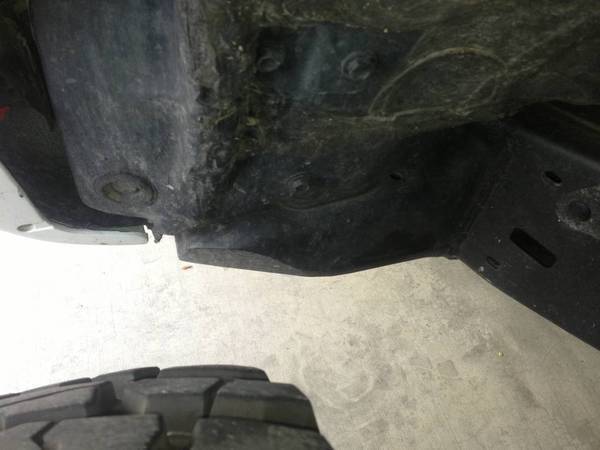

    This is for 285's but I will be cutting another inch off.
