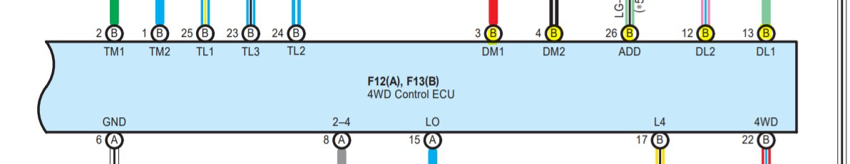

    Here's the diagram for the switch. Whether you make one or not depends on how you want the truck to operate and how you use it. For me, I ran the ADD switch for a while but eventually I broke the front differential and used that as an opportunity to go full manual. Personally, if your front actuator is working, I'd wire it up. You can always leave it permanently engaged if you want.

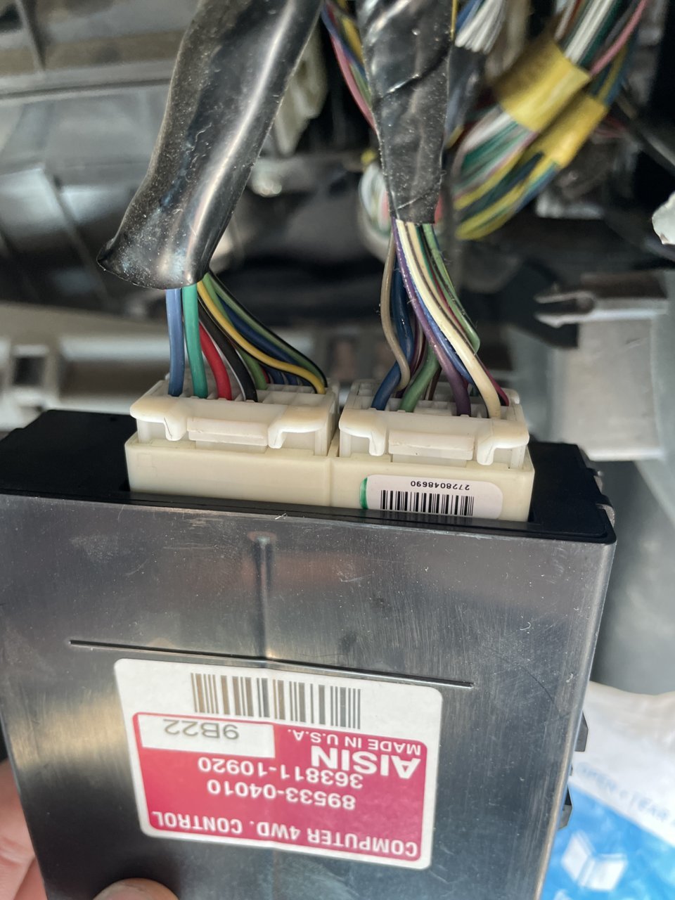

    Right on thank you @6 gearT444E
    Do you have a picture lol
    I have no idea what I’m looking at aha yes I understand putting a toggle switch on it to engage and disengage but what is the color and plug you know

    What plug am I looking at?

    You're looking at the F12 and F13 connectors right there in your picture. You'll want to use the F13 connector., the left one in your picture. The pin numbers of the F13(B) connector are referenced on my schematic I posted earlier. The purple wire is the +12V supply and comes from the F12 connector pin 5.
