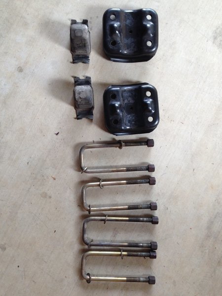

    Parts

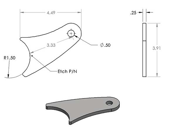

    2 sets of shock tabs (I used ruffstuff https://www.ruffstuffspecialties.com/R1653.html )
    Stock 6 lug ubolts and plates (You get get them used pretty cheap/free from other members)
    You don't need the bumpstops, I just stole this picture online lol

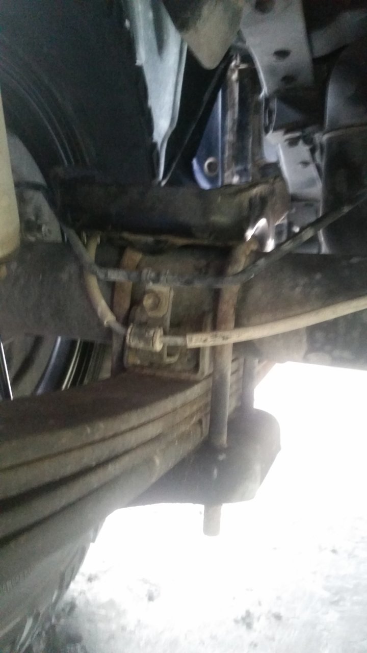

    Install
    Here is the general idea.
    1. Remove old ubolt stuff
    2. Add 6 lug ubolt stuff.
    3. Droop out suspension and weld new shock tabs

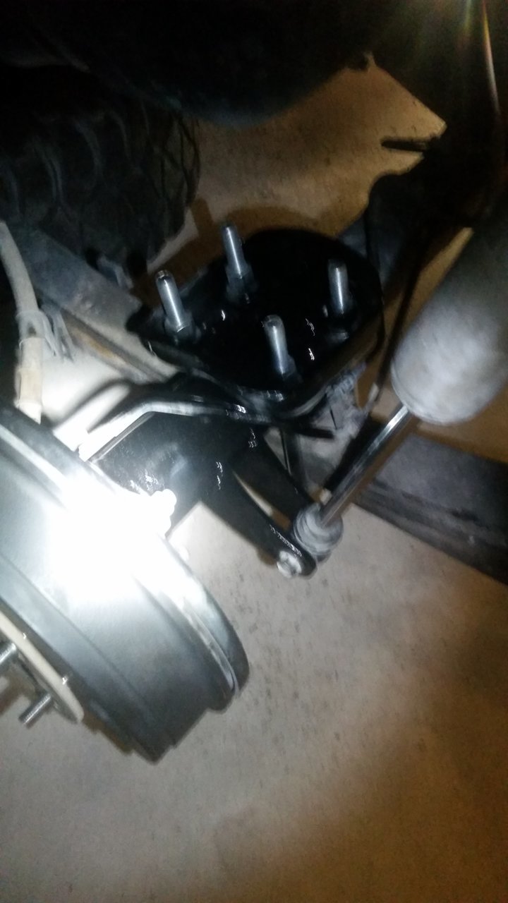

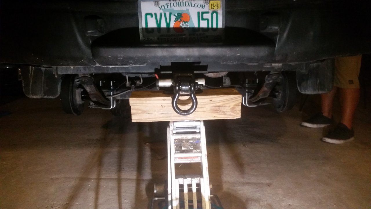

    Picture (Yes they are potato as they are from an old old phone)
    The idea

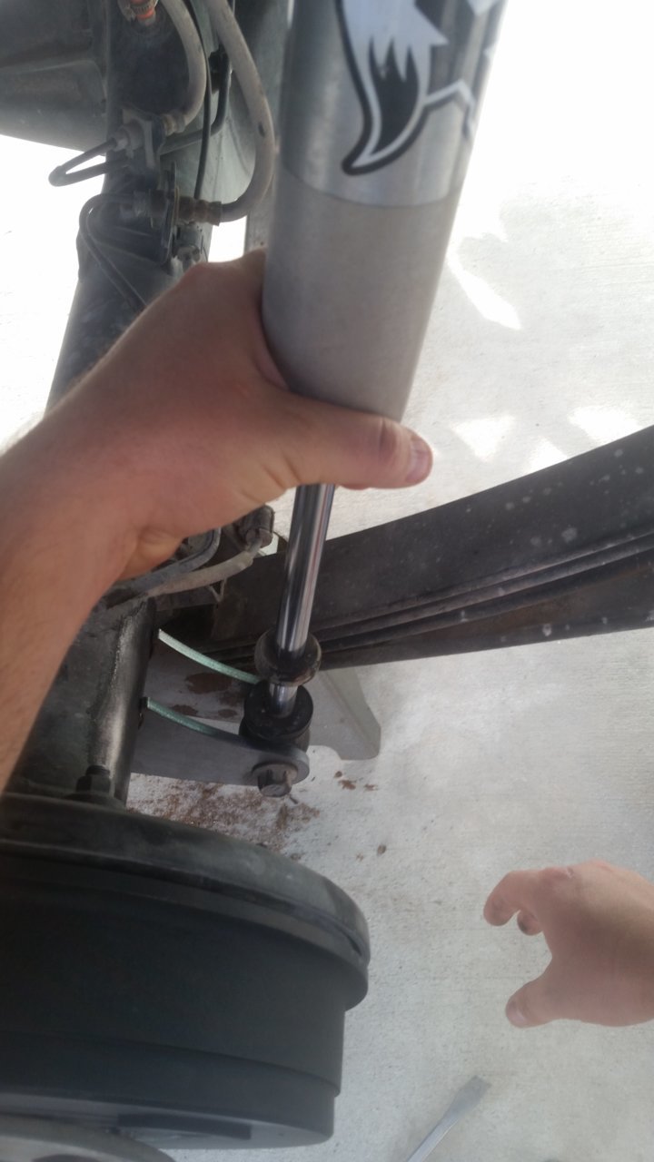

    Mocking the new tabs
    Welding new tabs (Make sure shackles are fully extended)

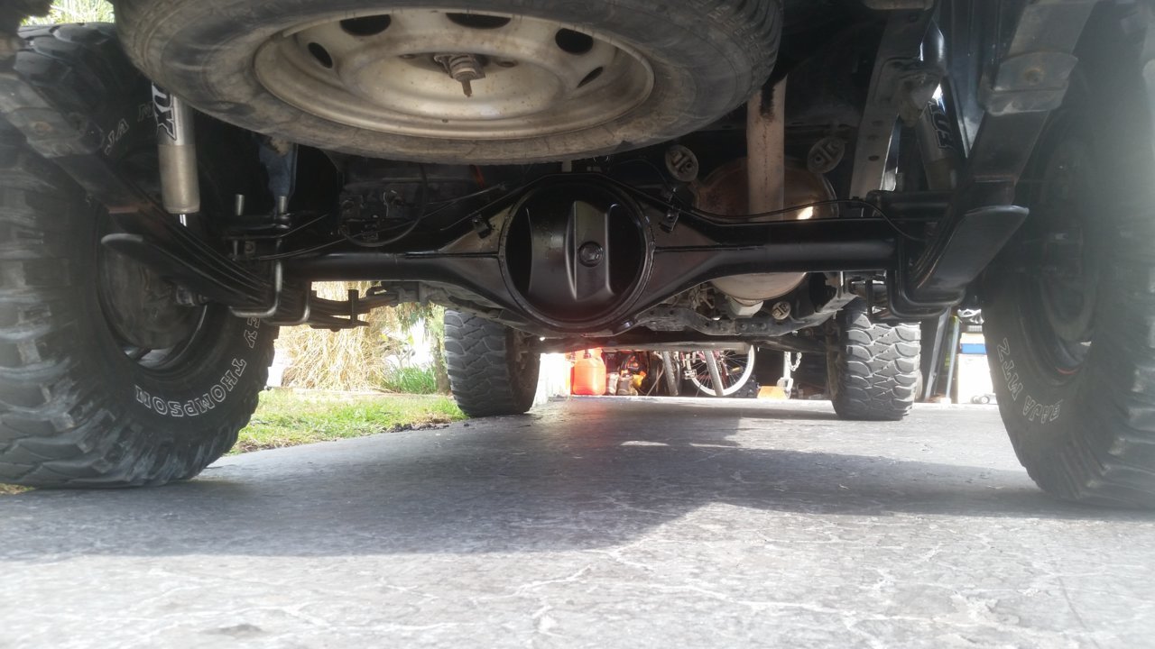

    Finished product
    Enjoy!!!
