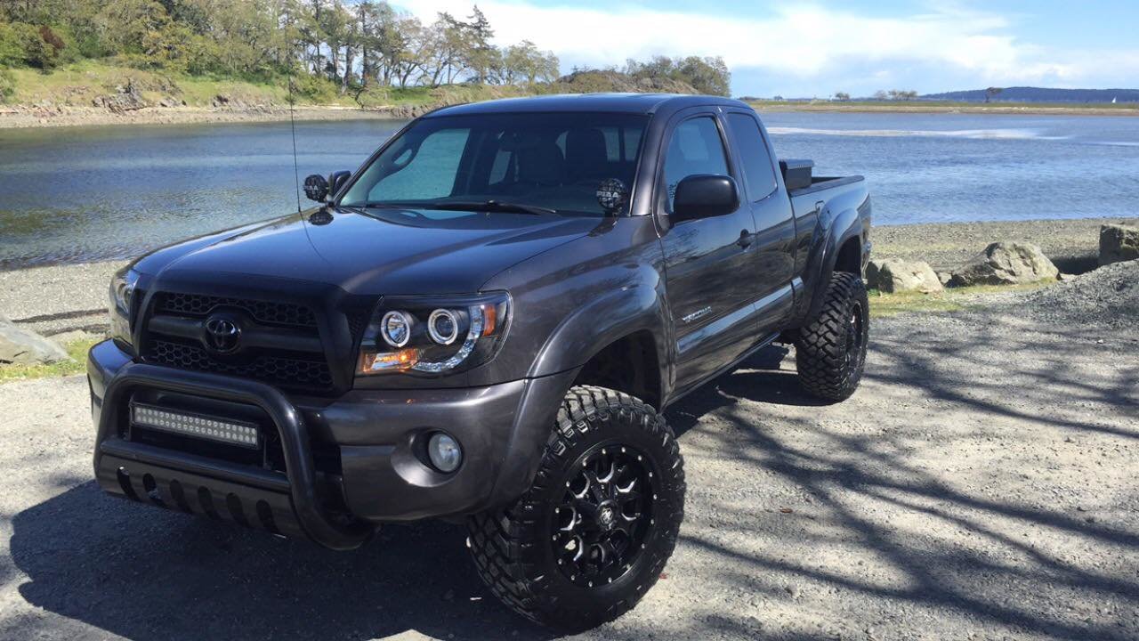

    Hi Guys I was wonder whether anyone has or could shed some light on how my truck will sit if I put Bilstein 5100s in the front and rear and where I should have them adjusted too if my tacoma already has a leveling kit in it.

    If you set the 5100s on the lowest setting they will sit the exact same as your truck does right now, if you transfer the leveling kit over.
    What kind of leveling kit do you have?

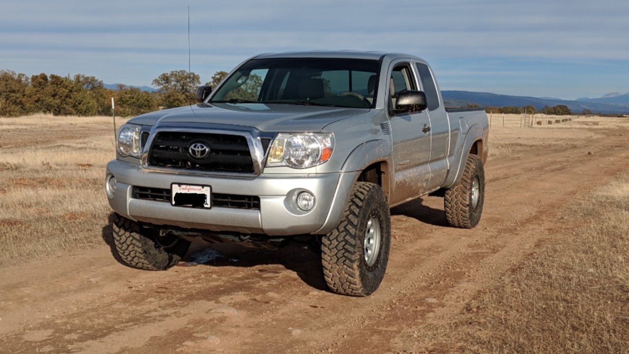

    Here's my truck with 5100s set at one setting below the top (1.75") and a stock rear end.90255760.jpg
